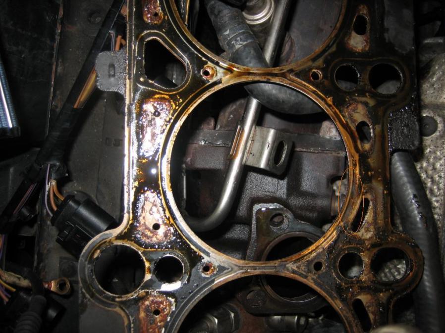

if this is hole #3, it would concern me. look closely for my circled area
