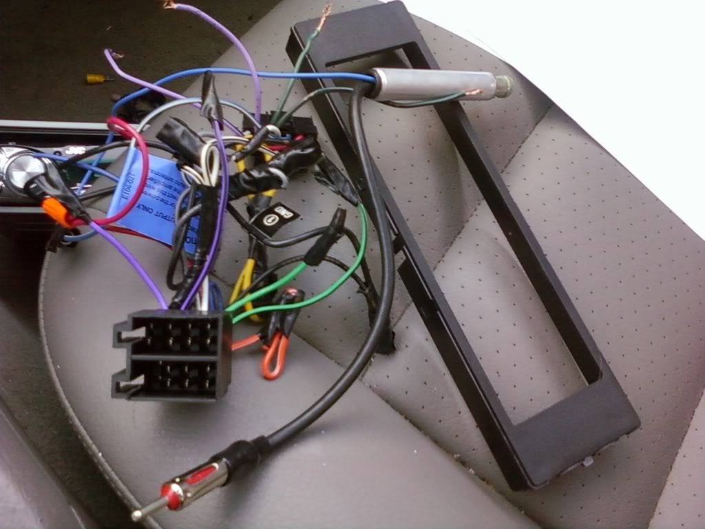

Okay so I got some pics of the wring harness and the stock stereo wiring. Maybe someone could help shed some light for me as to what I am missing or what I need to do. Thanks in advance.
THE KIT I GOT OFF EBAY:

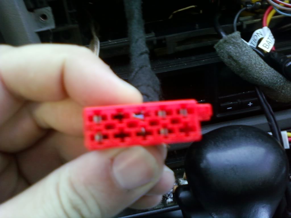

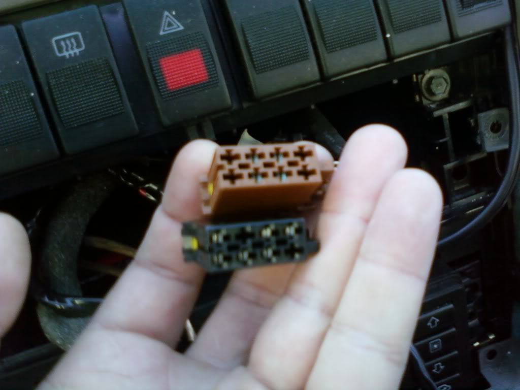

THE TWO FACTORY CONNECTORS THAT PLUG IN AND POWER UP THE RADIO AND PLAY SOUND THROUGH FRONT SPEAKERS:

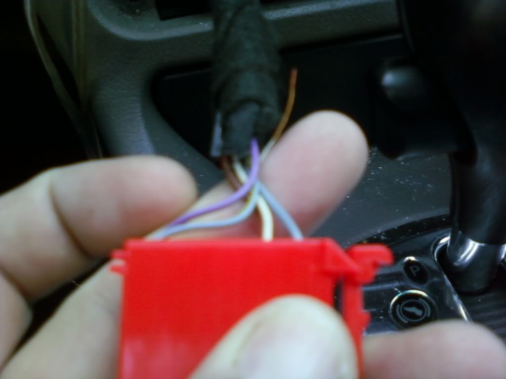

WHAT I ASSUME IS THE FACTORY CONNECTOR TO THE REAR SPEAKERS??:
Old Dec 30, 2008 | 09:46 PM
Jc61990's Avatar
Posts: 3,326
From: Long Island, New York
nope rear speakers is black, and has a lot of connectors on it

if your rear speakers are powered by an amp then i think you need this kit
http://www.crutchfield.com/p_1207017...g-Harness.html
where you connect the plugs from the red harness to your aftermarket receiver for the front and rear speakers. its hard to tell from the pictures but it looks like you have the black wiring harness but not the red one.

Okay, I see the one you are talking about. Thanks. What is the red one for? Just curious?
