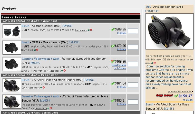

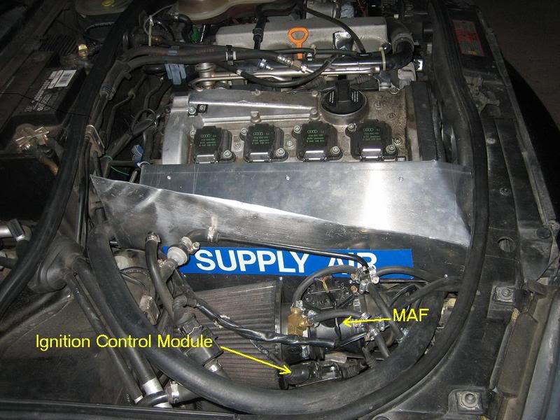

and your sure that plug isnt my MAF its mounted ontop of my stock airbox, and my cold air intake should be coming soon, so i want to make sure i can hook it up without having to go out and get an adapter

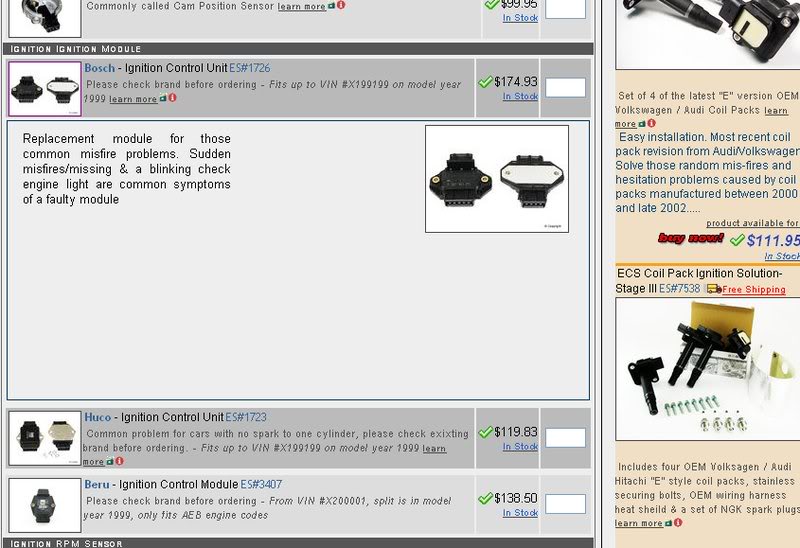

Your MAF needs to go in your intake air stream.
Your ICM just needs to be connected with the little heat sink(that is currently on the inside of your air box) on it. You can just let it hang there.

AAAAGGGGGHHHH. YOU DON'T NEED TO BUY ANYTHING ELSE.
Take the MAF out of your air box and just hook it into your new intake. You might have to get a home depotrubber plumbing connector. Then just take your ICM off the box, take it's little heat sink out of the inside of the box, attach it back directly on the ICM.
And you're done. Just go take your air box apart and you will see everything.

Just posted the pics to give you a better view of the parts not in the car.
