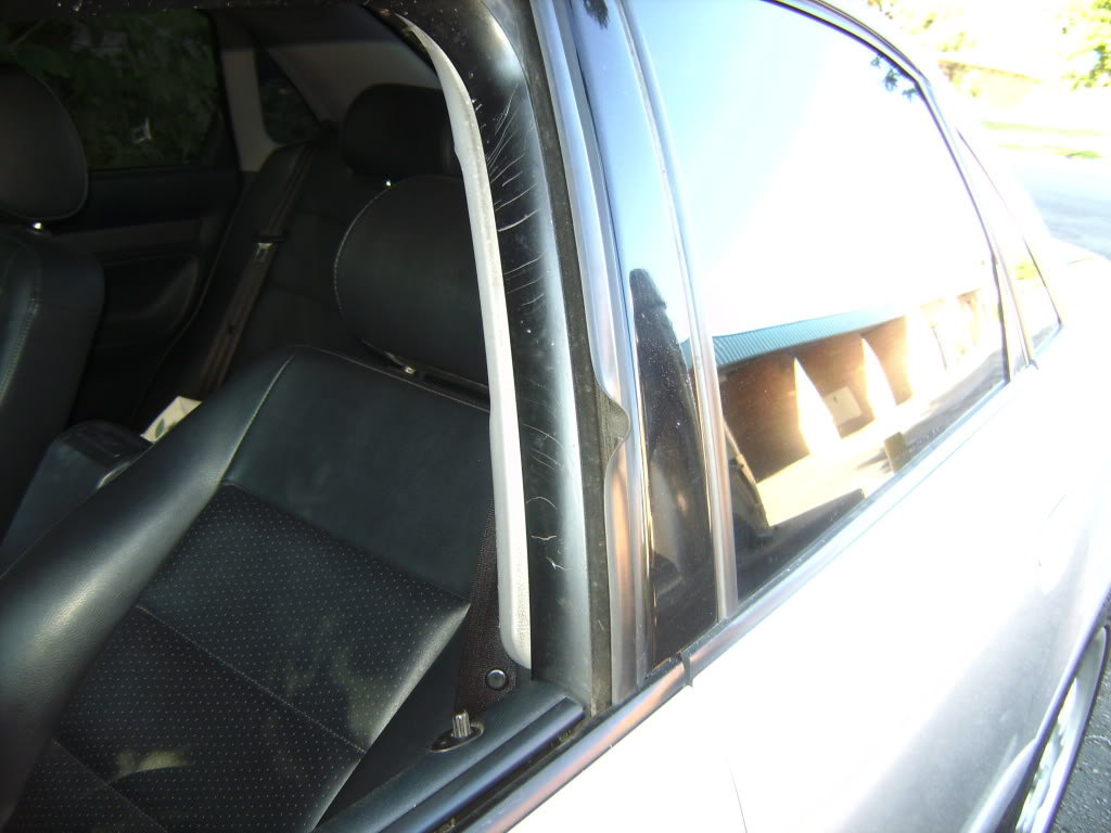

McGovs: Sorry to see that man, definitely not something I'd want to find. Though, I was under the impression that the red light did continue to blink even if the alarm was tripped, no?
