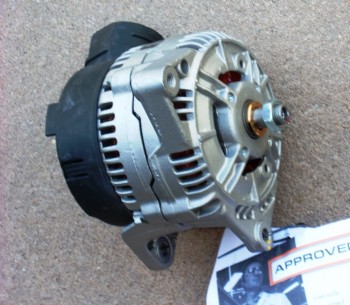

99.5 A4 Q, 2.8. Battery light came on today for about 15 miles, went off for 10 miles, then back on. Day before holiday, I had to get an alternator. First thing the dealer asked is if it's a Valeo or Denso. It's at my buddy's garage so I don't know. Got a remanned at O'Reilly for $160. I know it doesn't look like mine because I don't have the duct on the back for air cooling.
Am I OK putting this alternator in assuming it fits the brackets? 12 volts is 12 volts, and it's 120 amps. Why the questions (ECS wants to know too) about what brand my car came with?

My AHA alternator is made by Valeo. You can rebuild your own unit by replacing the brushes and voltage regulator. The Chinese reman crap sold at most parts stores isn't worth your time. I would suggest doing it yourself or find a local shop that will rebuild yours for you.

That's pretty much what I ended up doing. That cheapo remanned one I posted was a Bosch. Mine is a Valeo. I read several posts that said you can swap the two by changing a plug to an eyelet and getting a longer bolt to fasten it to the bracket.
Wrong. Those guys didn't measure how far the pulley sticks out from the engine block. The Valeo pulley on a Bosch sticks out an extra 4mm. Maybe those guys got away with that: maybe they're wondering why they keep eating serp belts. I dunno. I didn't like it and don't have a way to machine the Valeo pulley.
So I used Walky Talky's DIY over at the Zine. It was the 4th of July, I had to get my car back together and the nearest brushes I could find were NAPA's ECH F425. Dimension is perfect in one direction, I had to file a bit on the sides. My VAG-COM showed 12.2 volts Wednesday afternoon, it shows 13.7 now!
