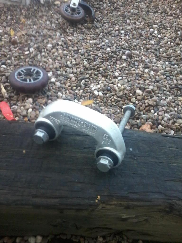

any1 know what part this is

when i bought my a4 the guy had a few parts with it he told me its for drivers side front suspension and there is a knocking, can some1 twell me what it is called so i can look up how to fit it, thanks

That's a sway bar end link.
Here's a sway bar DIY I wrote last year. There are others out there if you do some searching.
https://www.audiforums.com/forum/b5-...ar-diy-185341/

thanks for that BaseDrifter looked at your write up and looks clear and as you said in it i have that knocking when going over bumps, thanks mate
