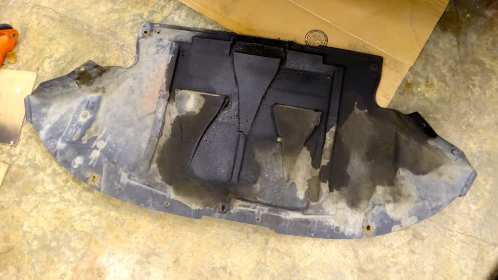

Remove wind tray/engine cover.
Now show your car how much you love her and clean the crap out of that disgusting oil and road grime soaked cover. (It is also very clear I have an oil leak. Seems to be coming from my oil cooler, add that to my to do list...)

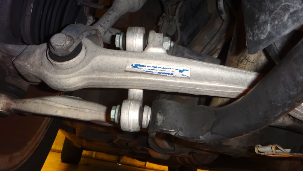

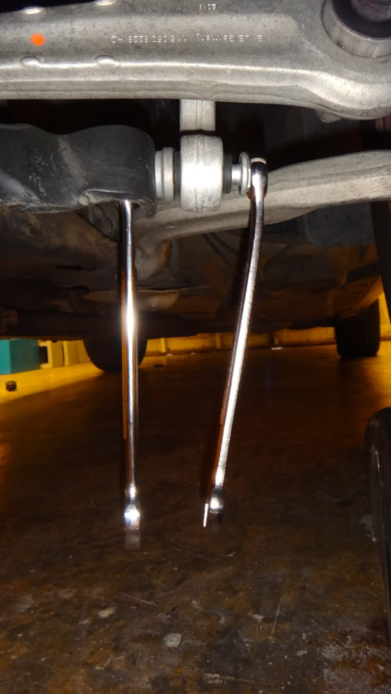

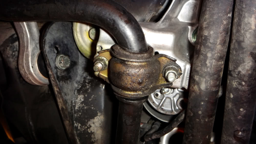

Start by disconnecting both end links. On my car the bolt head was 17mm and the nut was 16mm. Loosen both sides and remove the bolt. Note the nice and shiny new control arms! Yours can look like that too! Do it.
Now you can remove the 4 13mm nuts holding the bar to the car.

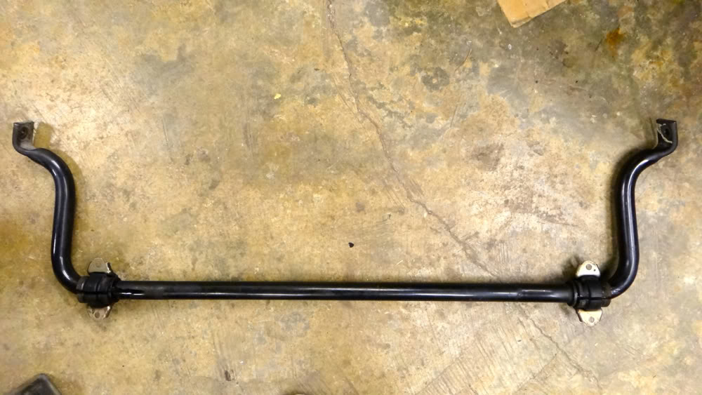

Thats it! Remove the sway bar.

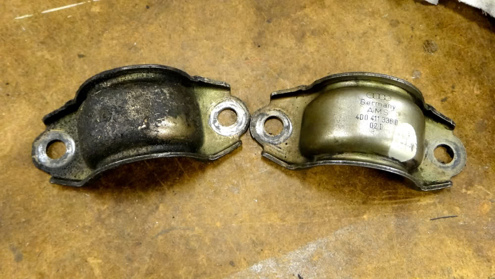

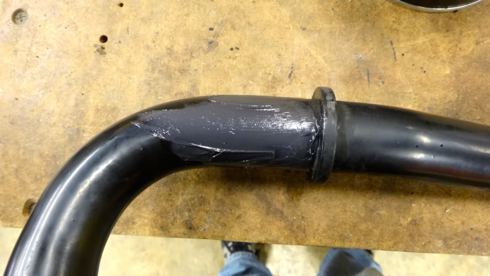

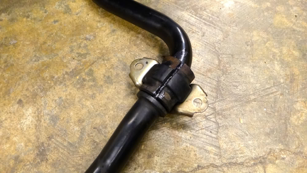

Because we all love our cars and want only the best for them. Take the time to clean up the sway bar mounts & bushings and give them a nice regrease.
Prepare the new bushings and mounts and proceed to installation. Reverse the above and have fun doing it!
