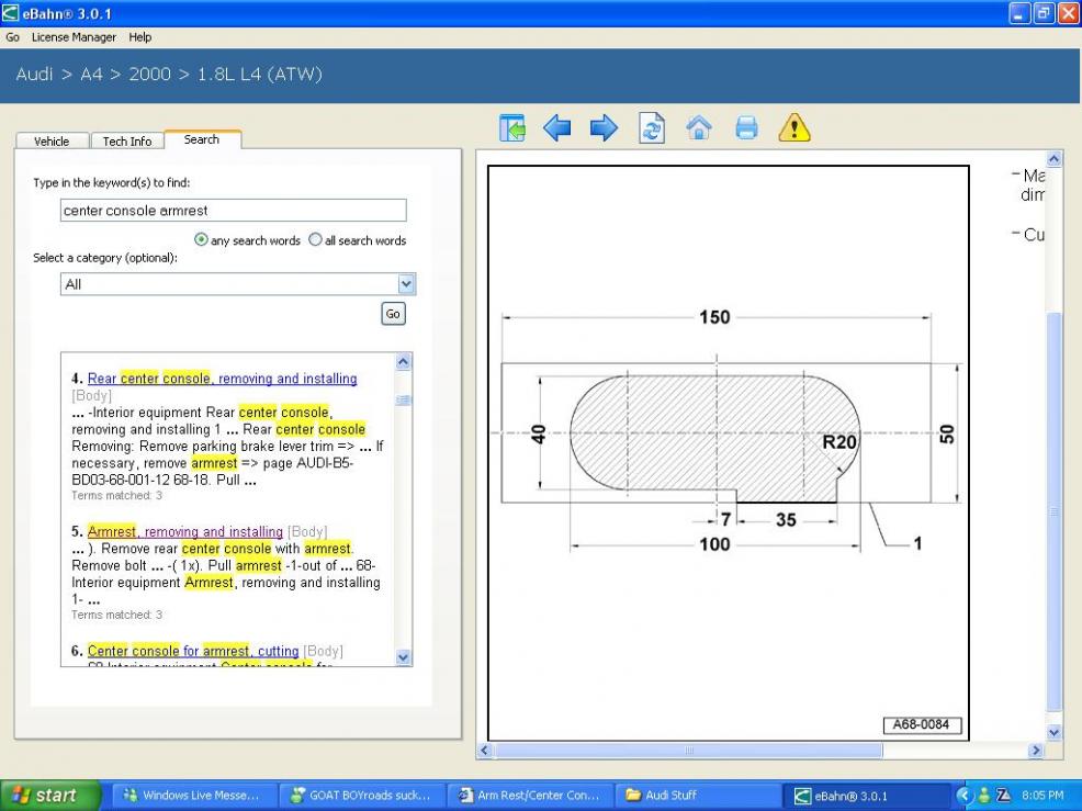

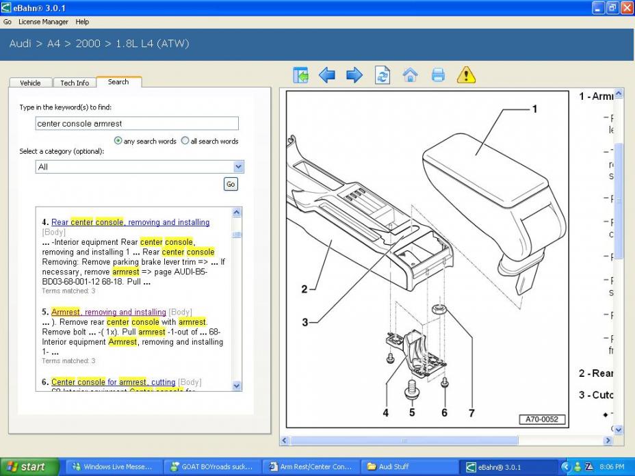

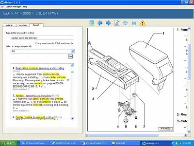

some cars never came with armrests, heres the "write up" if u wanna call it that.
you can buy mine if you want, all you need is a lid, lids cost 118 bucks new.
the lid stiching came off, and the idiot i sent the lid to decided to lets say "make a new one" and kinda destroyed it.
