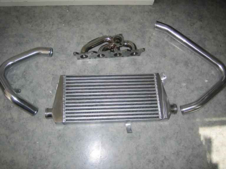

Got the Autobahn88 FMIC, manifold, airfilter and Forge style BOV...
I must say it's super quality! Haven't installed it yet...

I had some silicone elbows from them on my old RX-7. Fitment was not what I had hoped for but they did the job just fine when you trimmed them a bit. The elbows were kind of just like generic 90* elbows and were sold to be for the car which they really were not. I don't know how the rest of there stuff is but from what I have read its always iffy to get manifolds from unknown brands.

audicoupe, if you can, post pics after the install. ive been debating whether or not to try out that fmic kit so hopefully you can provide some insight on fitment and changes in performance. it seems like a quality kit but ive never read a first hand review on it.

Sure I've got over 500hp... or maybe more like 240 but I'll try it!
I'll snap some pics of the install when I get to it probably some time next week!
This far everything looks great, all the welds look good and so on. And also all the required pipes and siliconepasrts was included in the package!
