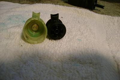

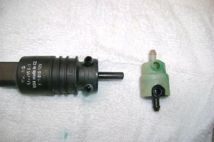

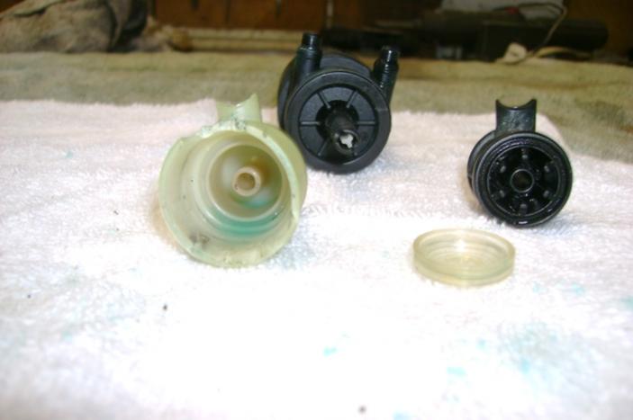

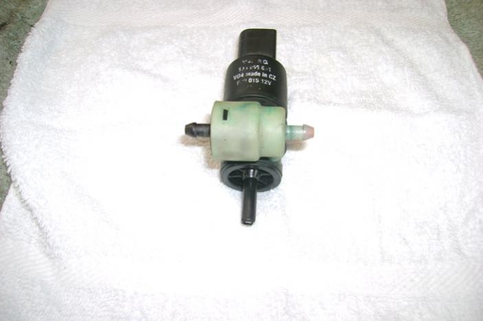

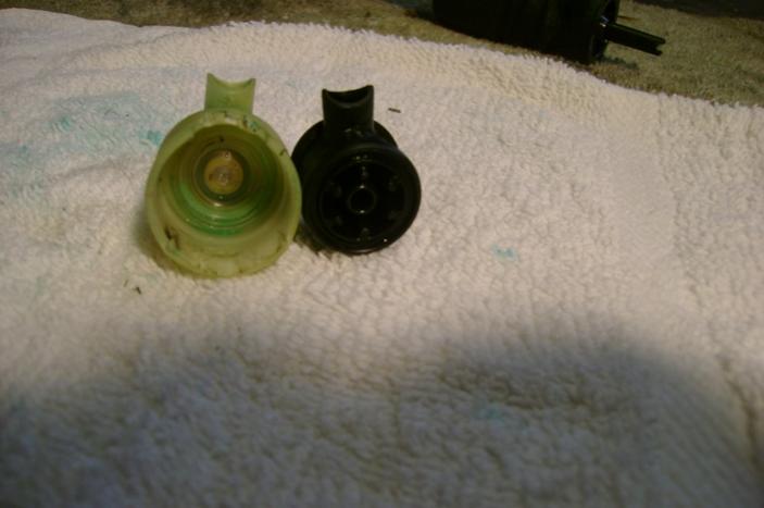

Well, I finally got around to changing the windshield/rear window washer pump for a new one. I dissected the old one apart to see how it worked.
In essecence it is like two pumps in one with a directional check valve if you will, attached. When the impellar turns in one direction the check valve diaphragm is pulled and pushed in the direction that allows flow from the desired port. Reversing the direction of the impellar rotation reverses the direction of the diaphragm movement allowing flow to go out the other port.
Prettey clever if you ask me.
