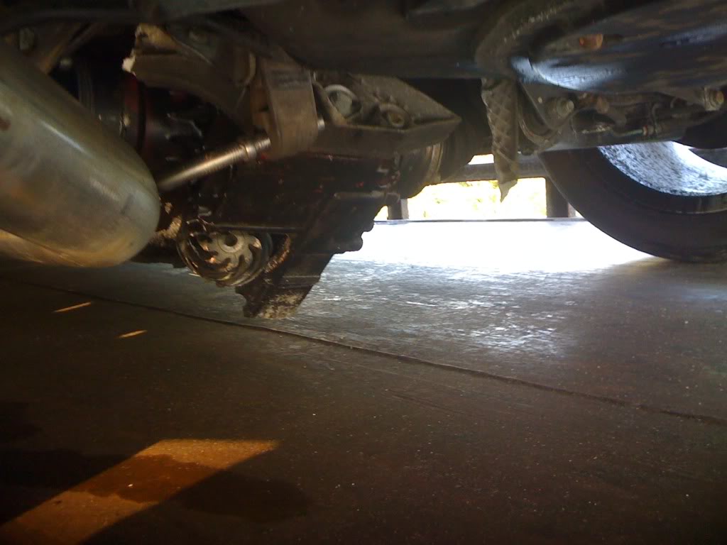

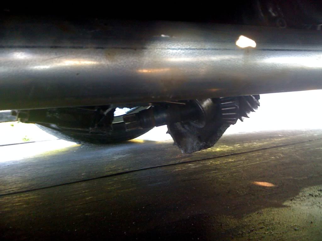

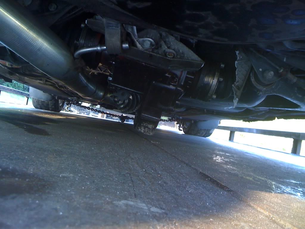

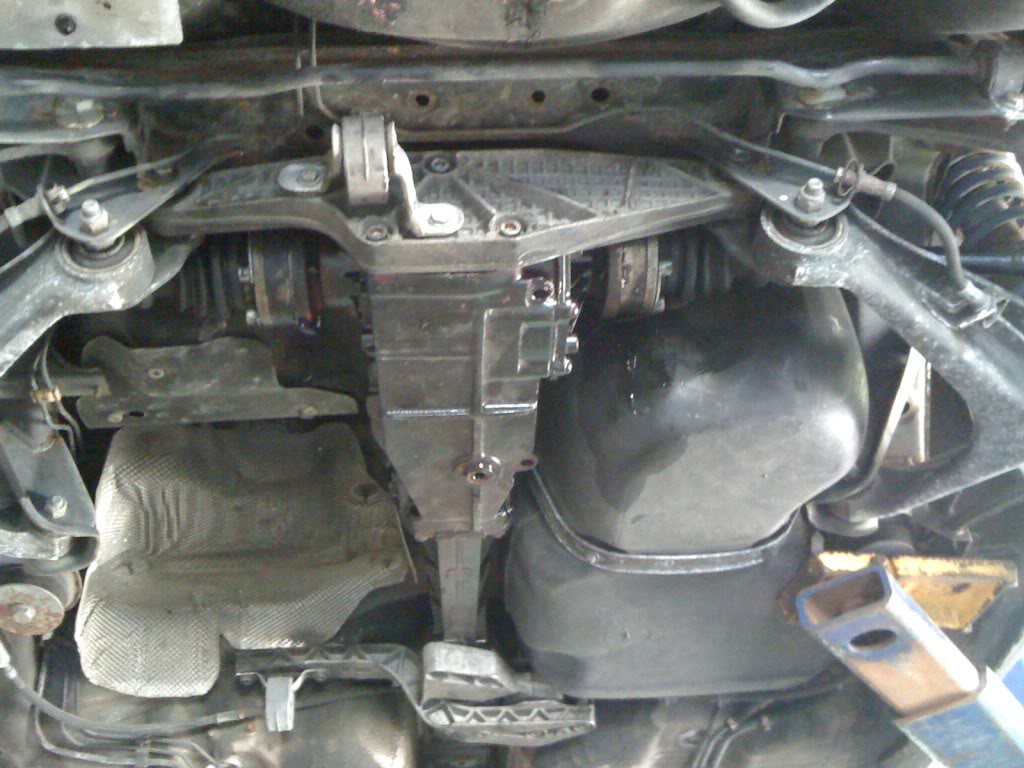

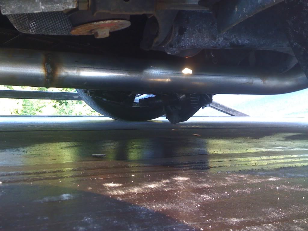

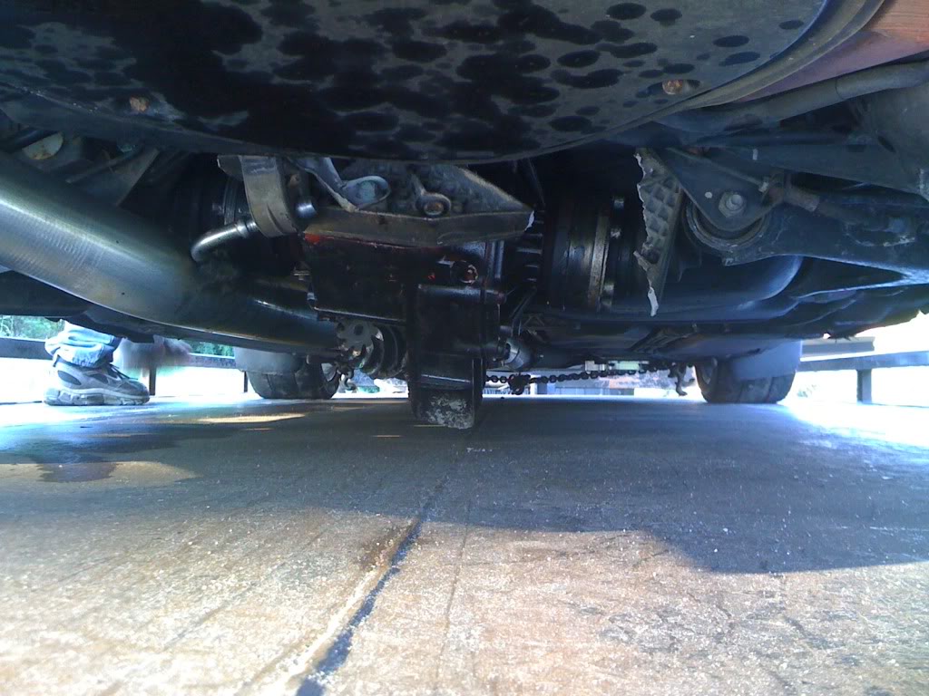

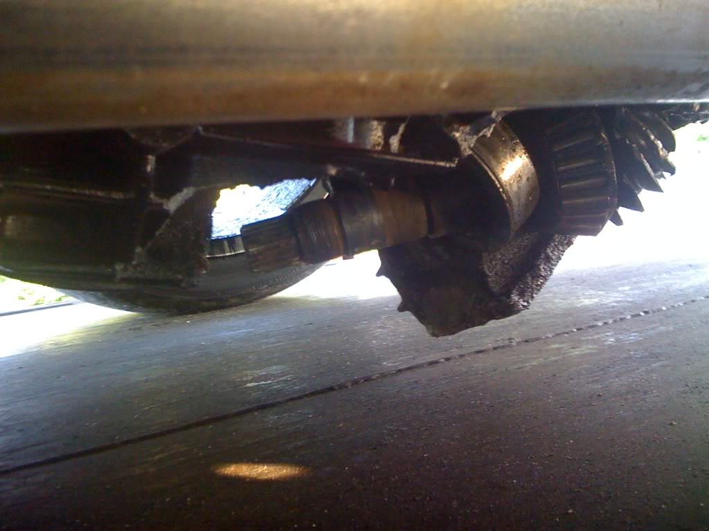

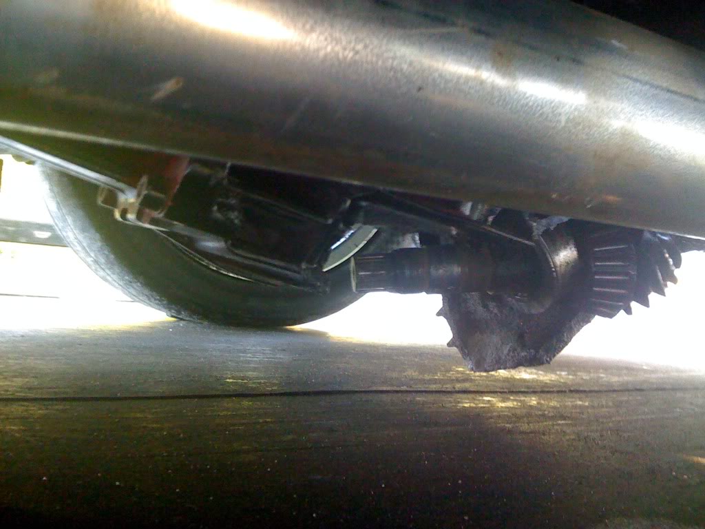

So i had the swap done at RAI motorsports. I provided them with the trans the axels and driveshaft and rear diff the rest they sourced for me. It was great for about 28 miles and then the rear diffirential exploded. Im guessing that no one checked to see if the rear diff had fluid in it. So i guess im buying a new rear diff and paying to have another one installed. tell me what you think.

Dear Audi gods... I'm praying to you today asking that you pleeeeeease never let this happen to my car!
Sorry about your hassles bro! You sure you weren't driving down a street in Iraq and get hit with an IED or something? That looks horrible! Just out of curiosity, is there an upgrade? That's how I get to justify upgrades to my wife... "since it needs to be replaced, I might as well spend the extra xxx bucks anyway, honey..."

Seeing the carnage makes my head hurt lol. I contemplated a swap, but I think I'd rather just get an S4 with 6 gears already in it
Good luck man! Any idea if the shop is willing to cover that, since you only made it 28 miles?
