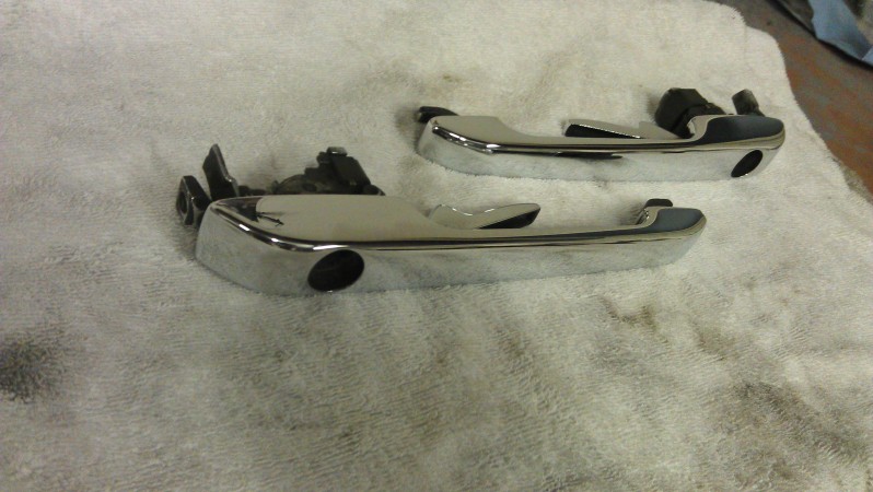

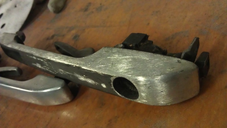

to fill in the time....

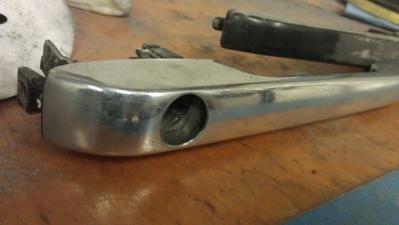

a little project I got asked to look at earlier,unscripted set of porsche handles that the owner had attempted to polish himself but gave up
standard finish removal didnt go to well

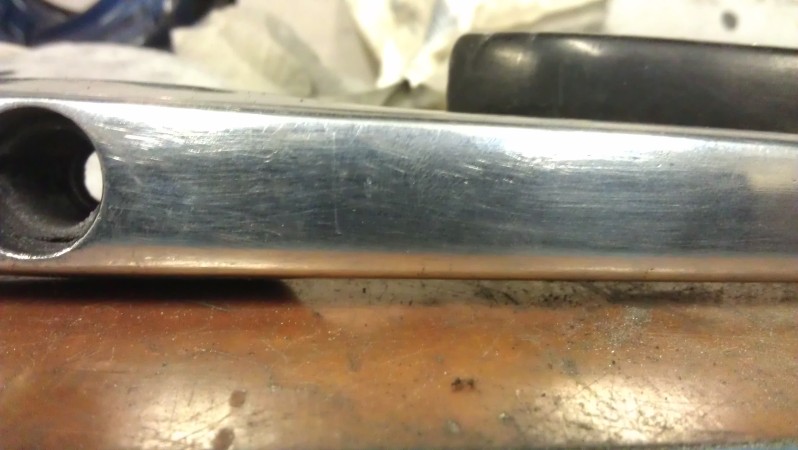

and trying to polish on top off is nigh on impossibubble(his attempt)

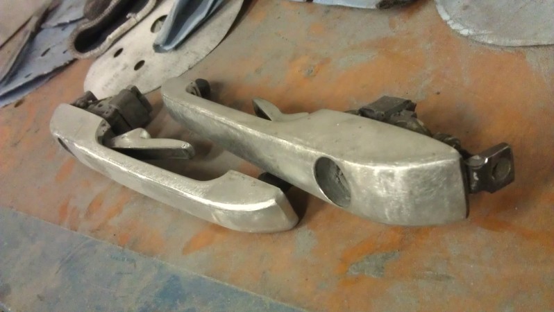

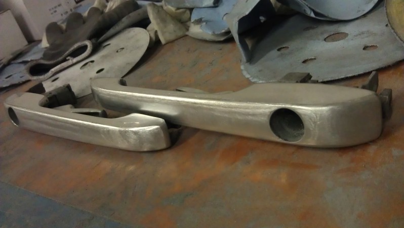

DA'd the remains through 120-240-500grit to remove the worst of the damage,hand sanded the triggers and tight areas

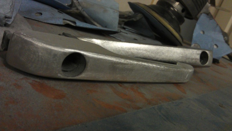

hand sanded the contours then re-DA'd them up to 1000grit

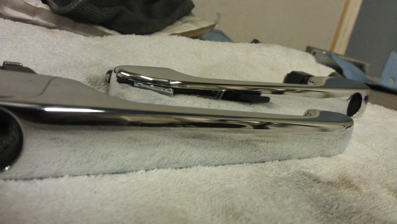

after finishing prep and a couple hours on the polishing mop.........
(trigger in reflection )
and arty-
-farty
so happy that I managed to rescue these,thought they were more than gubbed when I first looked at them

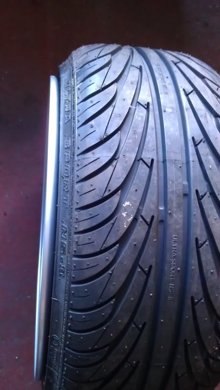

pics of the wheels again,my mate put them on for me and they werent even the challenge that I expected popped up really easy
soaped up
onto a 9.5
tyre on
beaded
should get them on next weekend hopefully
