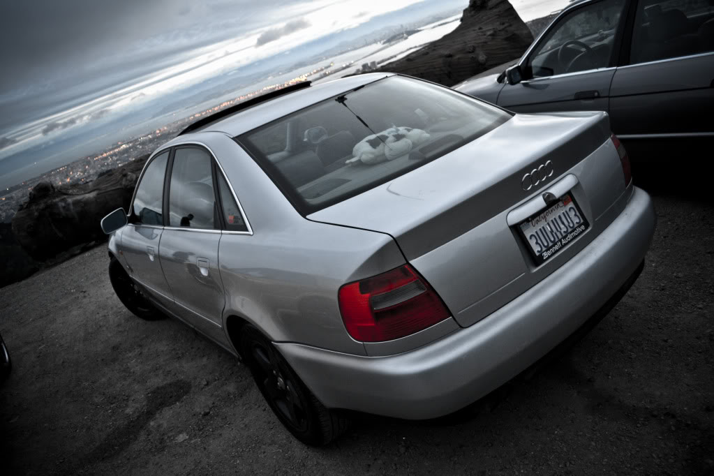

dont do razors... u dont wanna risk putting a scratch on your paint... the way i did mine was i used fishing line and after i got the badges off i soaked em in goo gone and rubbed off the adhesive... it takes lots of patience so dont expect all of it to be gone in 10 minutes... if you want you can search up videos on youtube to get an idea... search up "debadging a car" and you'll see what i mean...
heres a sample of a debadged b5 (my b5 )

yes indeed... never debadge the rings... it looks horrible without the rings in my opinion...
