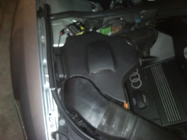

Ok so the flat tube coming out of the lower right hand corner of the picture is attached to a vent behind the front grille. Part of it is removable and part of it is not. The bit to the left with the grooves in it that turns down into the airbox just pops out, don't be afraid to yank it, its not gonna break. The black plastic thing shaped like Texas with the little scoop on it covers the top of the airbox and the MAF sensor, its held on by a coupla clips and also pops right off. With those two pieces removed you'll be able to see the top half of the airbox. There'll prolly be some wires and sensors and **** on top of the airbox lid, don't touch them lol. The airbox lid is held on by four silver clips, two on the right side and two on the left. If you're doing this shortly after driving the car, careful not to melt your hand off on the motor when unclipping the two on the right. With the clips un-done, you should be able to wiggle the lid off the airbox, revealing the air filter. That should get you up to the beginning of those airbox mod DIY's i posted a few posts up. Good luck!
EDIT: Forgot to add that obviously yours is gonna look different than that pic, being the 1.8 and all, but hopefully this helps at least a little?
