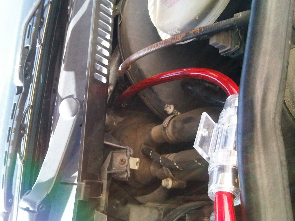

here is where mine is ran

thanks on the help just got it to fit in the ecu box.
now looks like i need to find someone to clean up the wiring under my dash.
