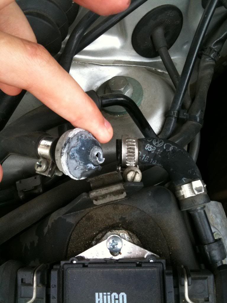

Well heres the piece...

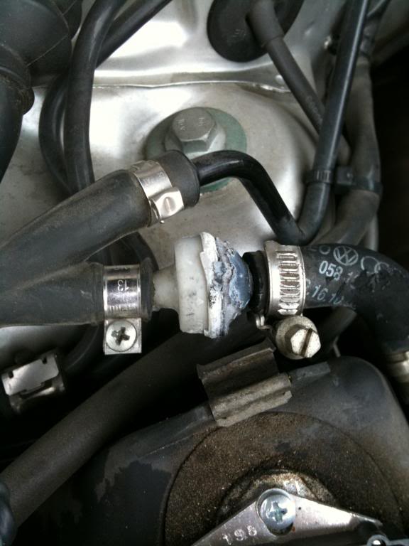

Another view to show you the brokeness!...

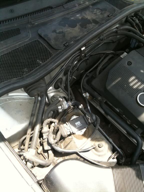

Just to show you were its located at in the engine bay

NOW... If anyone knows what this is or if it is even a big deal? Big thanks..
And is it is a big deal..does anyone know where to get the piece to replace it?
Thanks ahead of time...

are those fuel lines???

yes it is a big deal. it's a check valve. you can get a generic one from autozone that looks just like it. make sure you install it in the right direction of flow as it only let's air through one way. i'm surprised you're car's not running funny right now.
no it's not a fuel line mexican. it's a vacuum line

is it part of the evap system for the gas tank?

There are 6 of these check valves (+1 on tips cars) on various lines in the engine bay. If its broken you are losing vacuum and possibly also when in boost.
Most are linked to the PVC system, but the evap purge valve (not one of these check valves) is the one that handles the gas fume build up.
