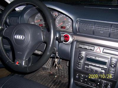

I just got my VEI gauge from Podi.ca, I didn't want to cut anything, so I bought
2" ABS pipe cap, drilled holes on the back of it.
In order for the gauge to sit in the cap, I had to turn it down a bit.
Connected it to the fuel pump wire, ran a vacuum hose...trick is - the vacuum hose should run almost straight from the back of the gauge, then I put 4-5 layers of self-adhesive (double side) tape so that the cap just sticks to my dash. No drilling or any mods on the dash, anywhere.

bbboy, how come you decided to put it where you did? seems like it would be hard to see while driving. looks like a clean install though, well done.
Old Oct 24, 2009 | 09:50 AM
bradtyler02's Avatar
Joined: Aug 2009
Posts: 5,312
From: Fort Irwin, CA
Yeah, that does look like a clean install. Nice DIY.

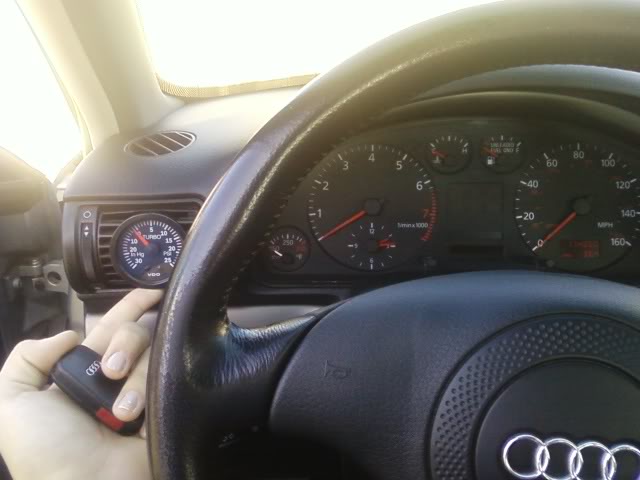

I did the vent mount pod, but since I'm cheap I used a dremel on my baby.
(How can people justfiy $2-300 on a boost gauge/pod!?) It took a few hours of dremeling and filing to get the fit perfect, but I'm really happy with it. All in all I'd say it was a 3.5/10 for difficulty because of the need for tools, the possibility of really ******* up your vent, and the time.
Drivers View: I'm holding it up with my fingers. It sits just a few degrees lower normally. I'm waiting to get an ultrabright LED (because the normal one is too dim) before I glue it in place.

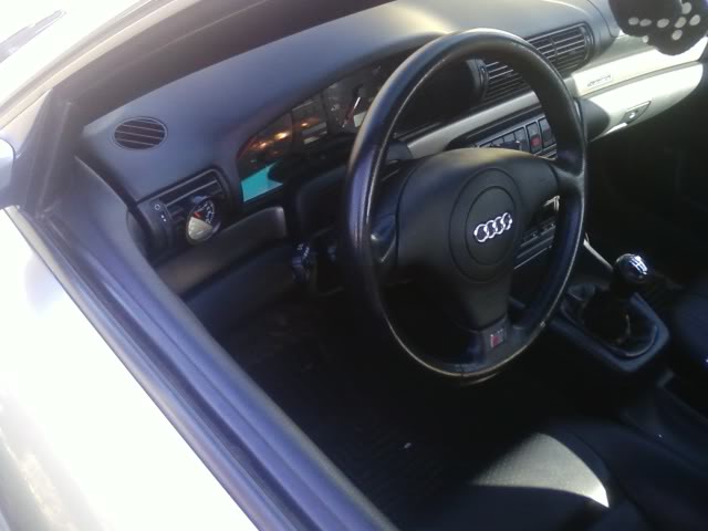

From outside: Most people dont even notice it.

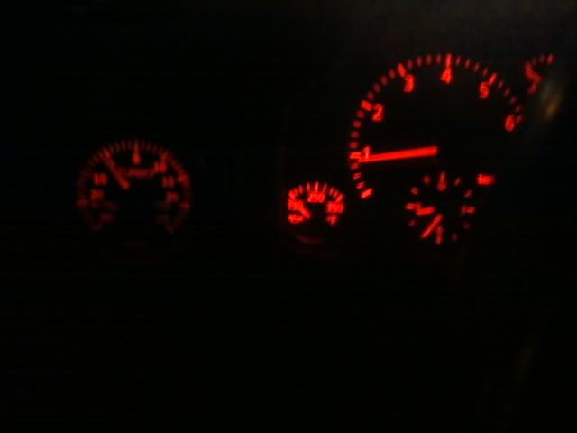

At Night: (Its a dimmer red than stock)
