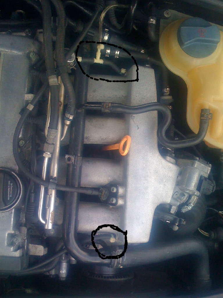

theres 2 spots you can do that or from the manifold and FPR. thats where i put mine.. looks cleaner.
those are the possible spots to tap into. if you tapped into the one on the right then check to make sure the other end is connected to the DV
Old Jan 25, 2009 | 10:12 PM
nova_ss672001's Avatar
Joined: Nov 2008
Posts: 471
From: Oxnard, Ca
yea cuz on my car, the line on the right goes around and connects back to the mani or something...
there isd another line right under it though that does connect to the dv,
mine is an 01 though?
