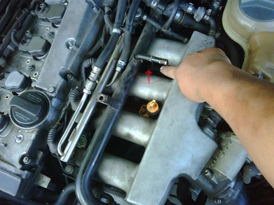

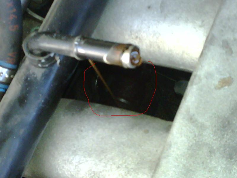

i did a boost leak test and heard a massive air flow slipping from a hard to reach area, under the small hose for the coolant. ive attached some pics. but its hard to tell what it is exactly, seems plastic to me. if any one knows the name of this part and where i can buy it , let me know thanks!!!!!!

its called an S-pipe, or crankcase rebreather tube. yes it is plastic and it does like to break.

how much? a lot. you can do it without removing the intake manifold if you move the coolant tank out of the way and snake your hand in there. its not especially hard, just a huge PITA.
