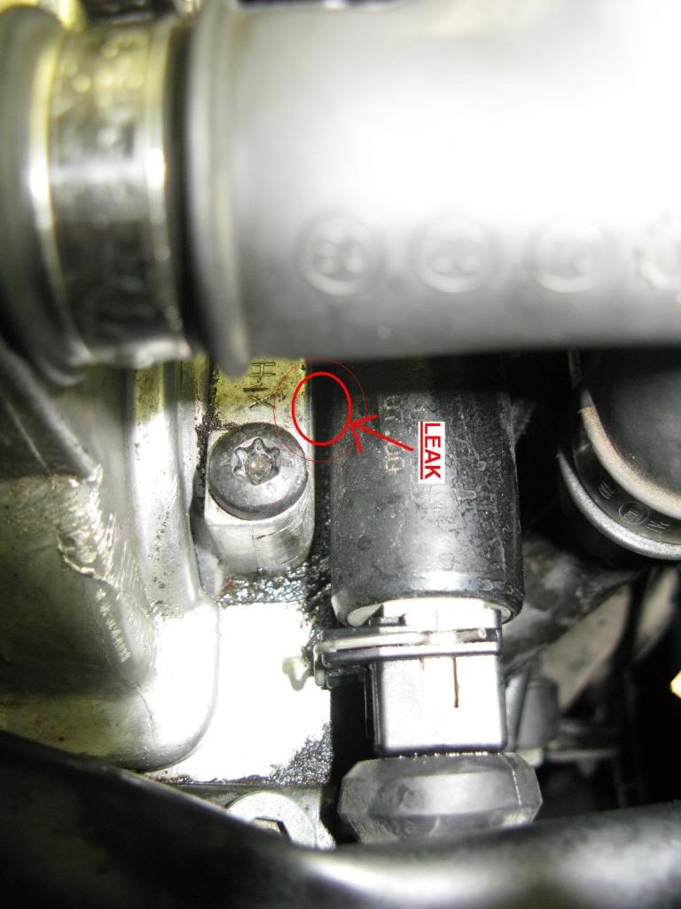

I was searching for boost leaks using the tennis ball method and found a strange one. Its located back by the firewall, very close to the valve cover, looks like a sensor mount or something.
The leak is occuring where the block and the other metal surfaces mate.
what is this sensor for? what is piece that I need to replace.
Thanks in advance.

damn, is that the half moon piece that requires the special tool?
(i just did my VCG BTW, oh well)

ok, i replaced cam tensioner seals.

I see you found your leak.. Good to know the tennis ball thing works.. Not so good to hear you found some new issues along with it :/

But still more suprises...after I finished the gaskets. I started the car and it sounded like there was a whole in my exhaust! Turned out that the bolts that hold the kombi-valve to the block had backed out due to vibration. One of the bolts was missing and the other one was hanging on by a few threads. I bought a new gasket and finaly got the kombi-valve secured.
The car seems to run fairly good now. But the boost is erratic. Sometimes it spikes to 14 psi, other time it only gets to 12 or 13 and holds at 11. I want to get it running properly before I swap in the N75J...
