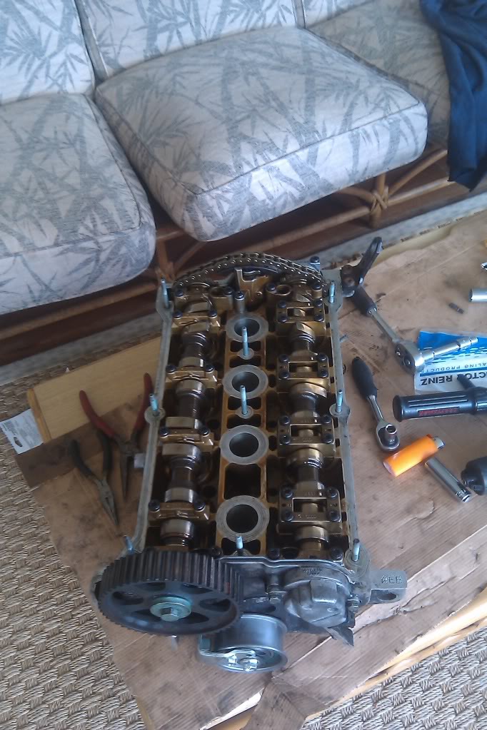

Here's a lil progress.
Timed.
And the helper.
Old Jun 9, 2010 | 08:18 AM
  #24
CCA4's Avatar
Posts: 7,588
From: NW PA
lol @ your helper. Looks to be coming along nicely! How does your wife feel about you building a motor on the rattan furniture?

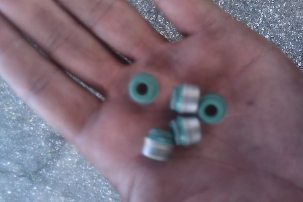

Yea I just grinded the cam cap a bit til it fit through.
But I still don't know what these are for
