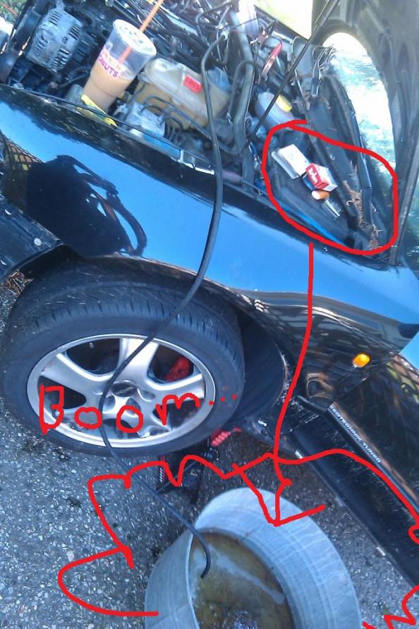

Found your problem.

Glad I wasn't the only one that saw that!

lol, thanks dad...
