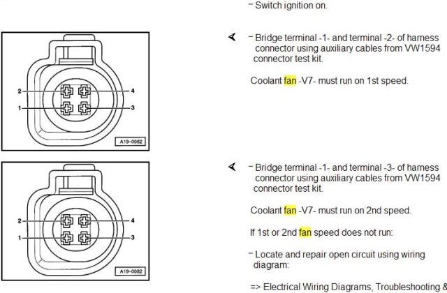

Before you throw another fan at it, here's Bentley's procedure for checking that fan. Make sure the fuse for the thermal switch in the fuse box is good (Bentley thinks it's fuse 34, but they aren't always right. Confirm on the diagram on the fuse box cover.) Then pull the plug off the thermal switch on the lower radiator hose. Then with the ignition on, bridge the pins as shown here. That will send 12 volts to the fan at the two speeds. Oh, you don't need VW1594. All you need is a wire that will make contact between the pins they describe. If the fan doesn't run, use a tester to confirm there is 12 volts on pin #1. If there is 12 volts there and no fan to pin #2 or #3, then your problem is the fan, or the wiring from the thermal switch plug to the fan.
