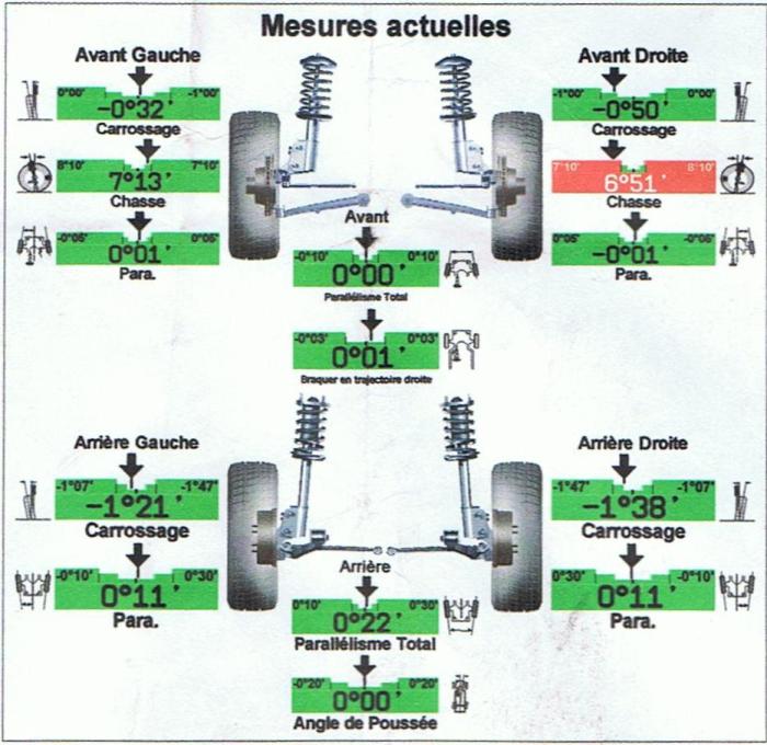

After an audi shop changed the rubber mountings under my car I discovered that my car was turning to the right. I went and got the tracking checked - all was fine except the parameter shown in the attached picture. My mecanic told me it hasen´t anything to do with my car tracking right...
And there was nothing he could do to correct it.
Here is my quistions:
1. Could the parameter thats out of limit be the reason for my car tracking right?
2. If not the reason - what else could it be?
2. Is there any way of correcting it?
My car: Audi A3, 2001, 1.9 tdi
Serial number: 8L
Thanks a lot for reading my post.

Well, thats 'Caster' and he's right. caster determines how fast the wheel re-centers after turning - like the wheels on a shopping cart. Looking at your specs, I dont see anything that jumps out at me.
