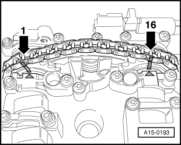

If that is a no go, then changing the tensioner is what you have to do. Changing the tensioner isn't much harder than changing the valve cover. Just take off the cover, un-bolt all the cam caps, use a channel lock to hold the timing belt to the cam sprocket, then pull up the tensioner. This all has to be done at TDC of course and the cams have timing marks at the back of them, the timing marks have to have 16 chain links between them like in the pic below. When re-installing the cams don't torque down the cam caps before running them all down by hand first, and only tighten them to 10NM. I had a couple crack on me just a little while ago, it isn't common, but it can happen on engines that have been overheated.
