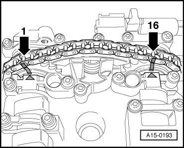

The special tool usually comes with a new tensioner, its easy to do if you know how.
Just follow the diagram, count 16 teeth between the timing marks and you're golden.

You have to take off the valve cover and take the cams loose, the procedure says to remove the timing belt but thats not needed. A shop will charge you 5.5 hours to do it. Just take off about half of the cam caps and tilt the cams off the head to get enough room to sneak the tensioner out of there. Slap the new one in (compressed of course) and count the teeth. The tensioner should come with a tool like this.
