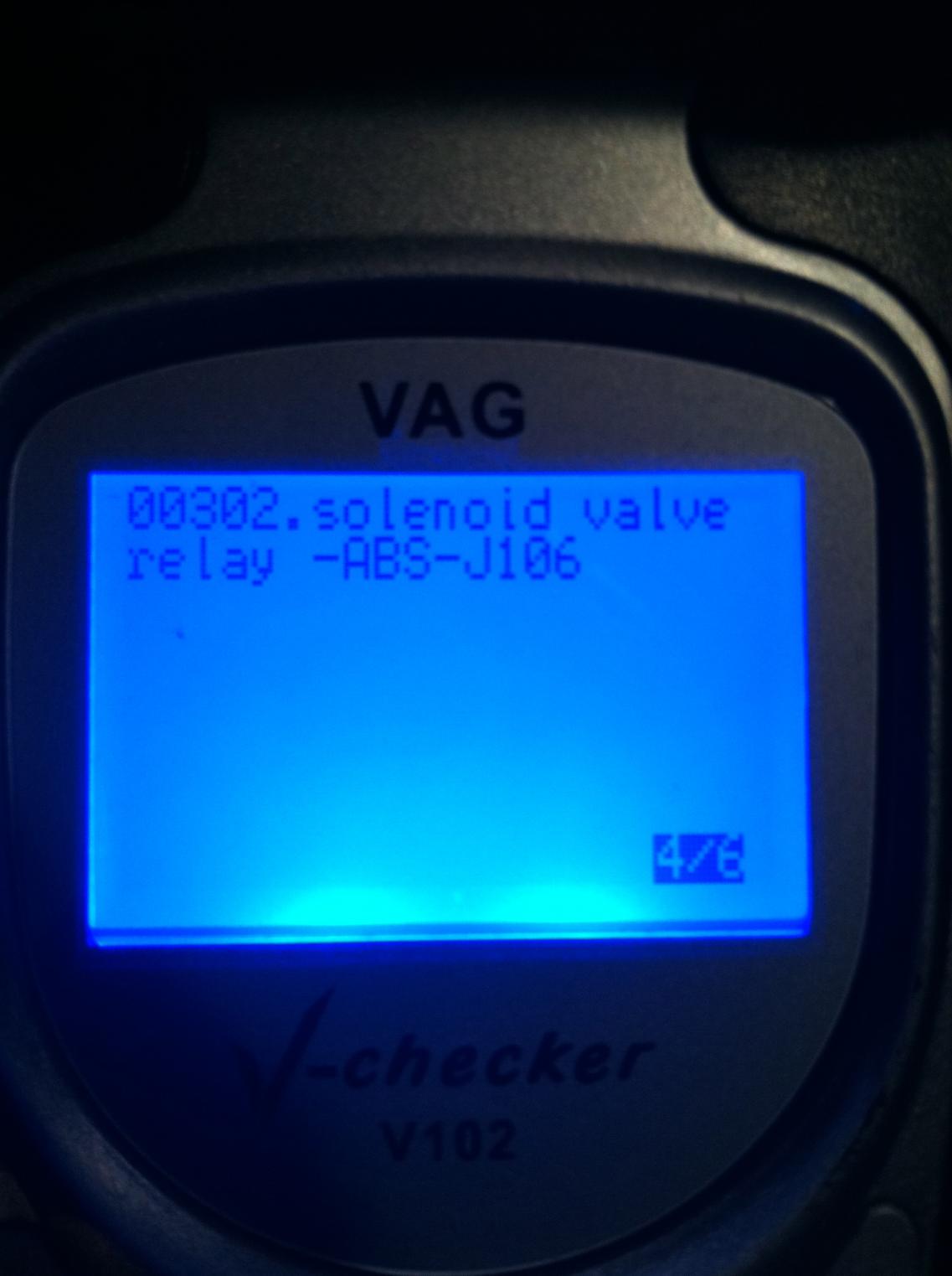

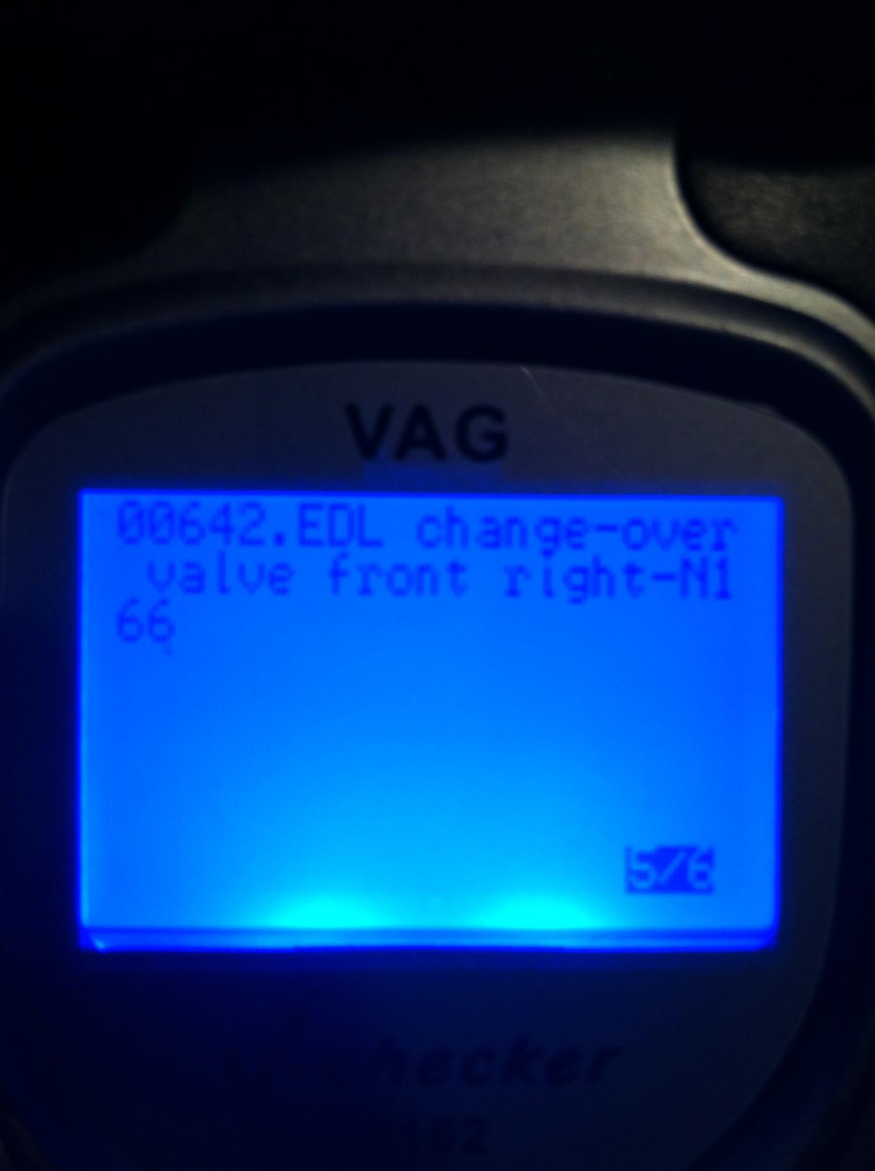

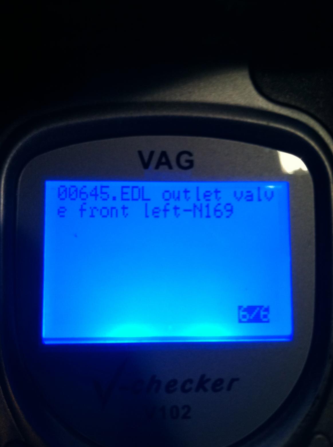

SO yet again my car has thrown some CEL's The codes I got are
P00302 - Solenoid Valve Relay -ABS-J106
P00642 - EDL change-over valve front right-N166
P00645 - EDL outlet valve front left-N169
How serious are these problems? And how much am I looking to spend to get these all fixed?

redline380 - My code reader that I got off ECS. I'll post the pictures with the codes.
McGovs2.7TB5 That's what I thought too. But what else could be ABS? And EDL controls the valves on the brakes to my undertstanding.

Attached Thumbnails CEL Codes :(-img_0090.jpg   CEL Codes :(-img_0091.jpg   CEL Codes :(-img_0092.jpg
