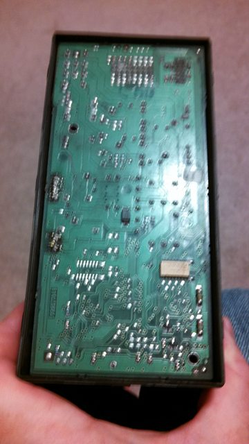

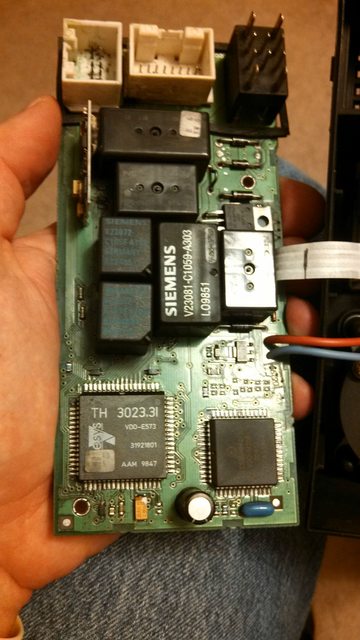

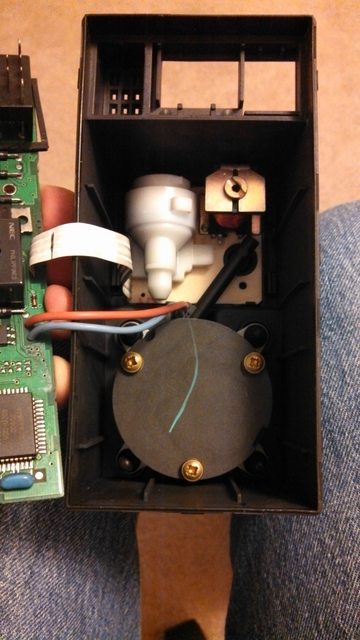

Picture time! Everybody loves picture time!
Here's the unit:
sorry for the blur
In all honesty it looks fairly decent though the pictures show it a bit better than it looks in person. It looks like some water got in there, not a lot, but some. And since the inner-driver-side-door button worked, I know the pump is fine.
My guess? Most of the module is okay, but some water got in there and short circuited the receiver, or the receiver area of the board. For whatever reason, the electronics that tell the pump to work the locks from the door button work, the rest is kaput. It's a damn shame because the pump is working, if only I could trade someone, or somehow just buy the receiver part. Oh well.
Whole units on ebay range http://www.ebay.com/itm/Audi-Central-Locking-Pump-w-module-A4-S4-A6-S6-A8-S8-Cabriolet-8L0862257N-/390675440159?pt=Motors_Car_Truck_Parts_Accessories&hash=item5af612221f&vxp=mtr to http://www.ebay.com/itm/Audi-A4-Central-Locking-Pump-8L0862257N-8L0-862-257-N-w-upgraded-graphite-pump-/200913232381?pt=Motors_Car_Truck_Parts_Accessories&hash=item2ec75ca1fd&vxp=mtr.
I guess I should just pick a cheap one because it's usually the pump that fails (as long as you keep the unit dry). Theoretically the receiver should work fine with whichever one I get then I can keep the old one as a replacement pump.
