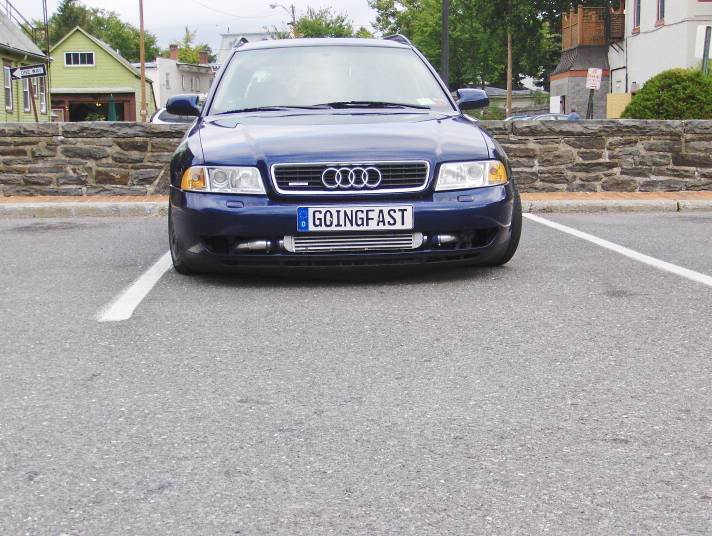

here is a shot of an Avant of FK's (sitting just where I want to be one day)
That looks really good but I think its a bit to low for me. So you do you think coil overs are the way to go. I live in Michigan and winters are a bitch so low is not good but if I could adjust them by the season instead of having to get an extra stock set that would be nice.
