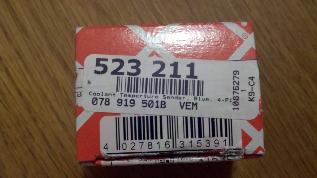

So I went to replace my failing ECT this morning. I ordered the blue one from ECS for my 99.5 2.8L.
I removed the connecter confirming that the original was blue. Before I removed the original, thankfully I opened the box. Much to my surprise, the replacement was green. The box is labeled as the blue one. Is this green a replacement for the blue or was it boxed incorrectly? What is the difference in the two?

nothing. same thing happened to me. the green one they advertise is a circle instead of a square. it will work. it solved my problems. i even contacted the support so its all good.

I had the same query when I ordered mine, called tech support and they confirmed just what jonesbonesjones said. Don't worry about the color.
