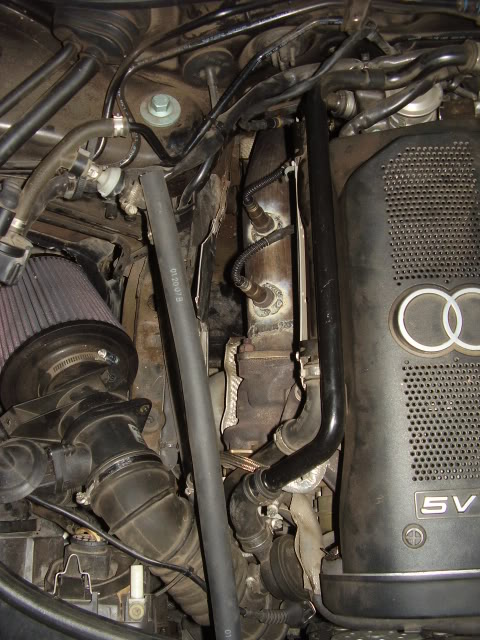

Here is my 02 sensor set-up:
Wanted to not drive the Jeep anymore, but am stuck. I don't want to keep driving it till a CEL comes on, cause the power surges are certain to kill my brand new clutch. Any advice?
