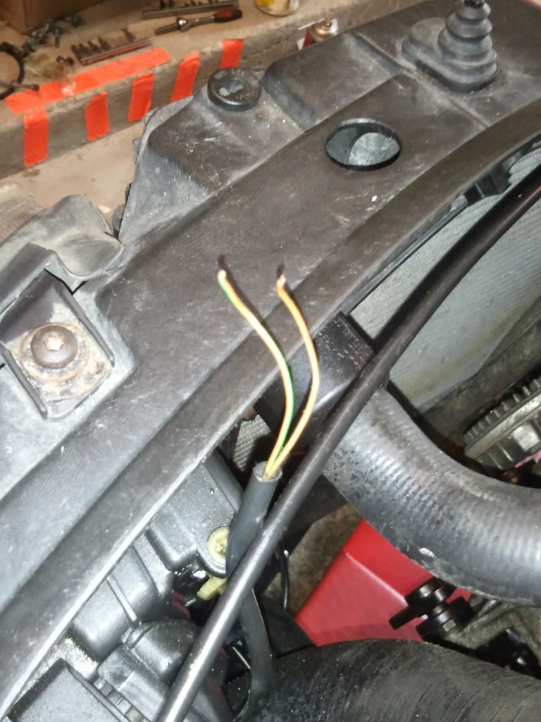

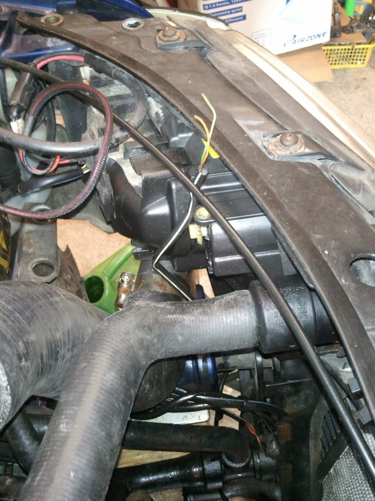

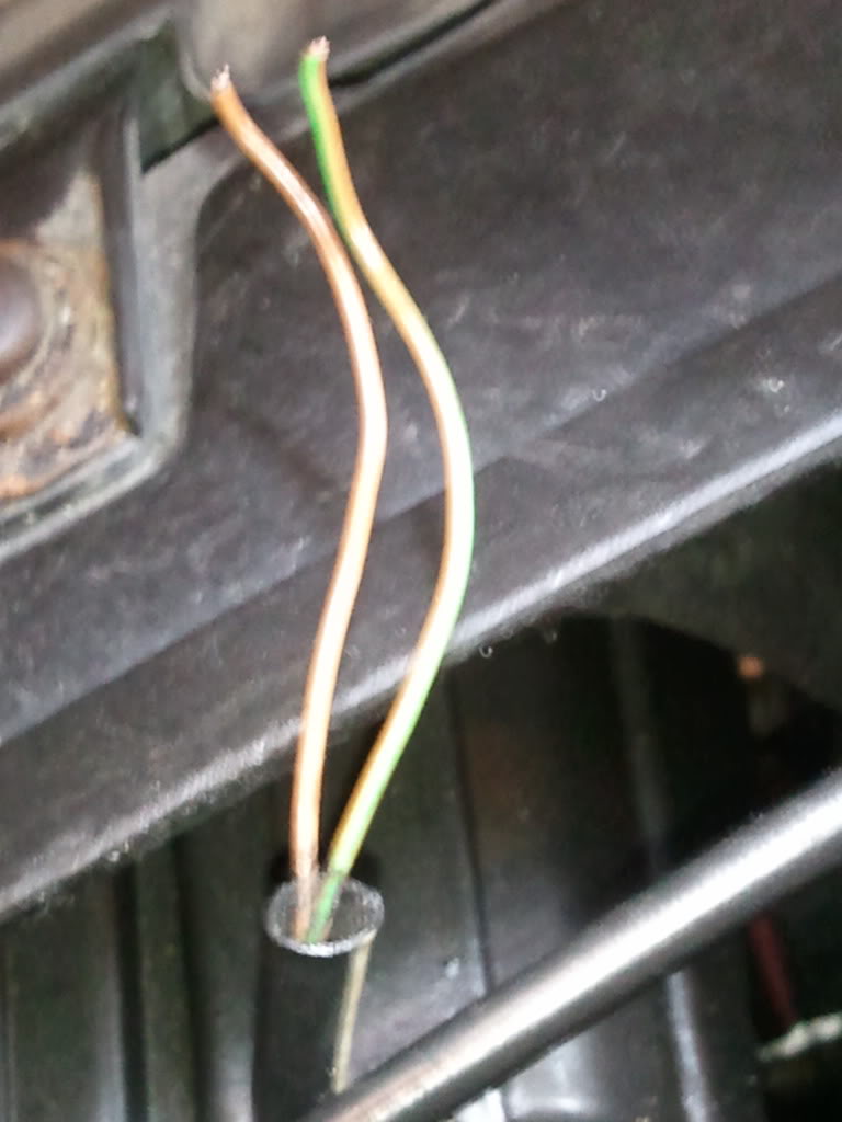

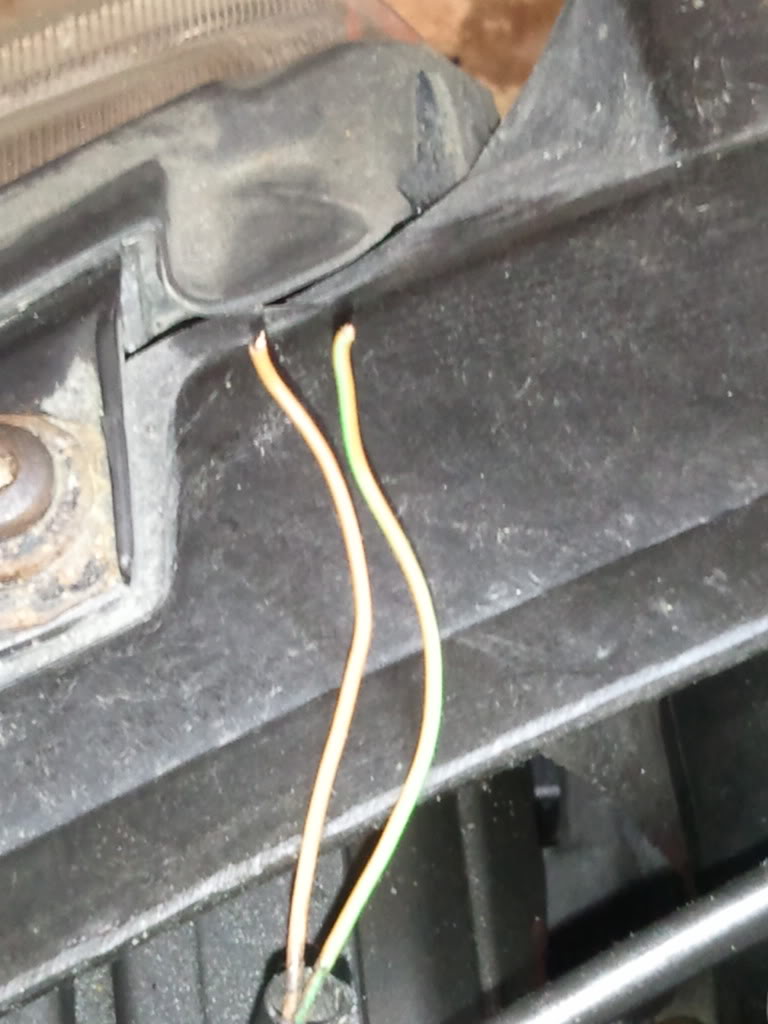

I found these 2 cut wires in the front driver side of the engine bay of my 1998 A4 B5 1.8T quattro manual AEB. Any idea were they belong?

Looks like they're for your hood switch sensor, seen at the top-right in your first picture. In your last picture (bottom-middle/far right) I see the two connectors that attach to the hood switch, with no wires sticking out of them.
