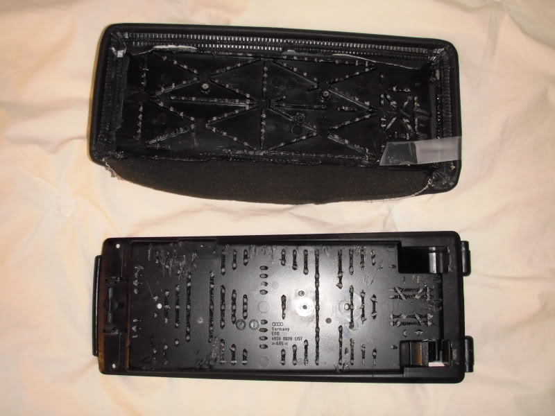

Step 2:
Separate the two pieces and expose where the leather is glued/melted on the inside edge. This will take some time and some large flat headed screwdrivers will aid the separation.

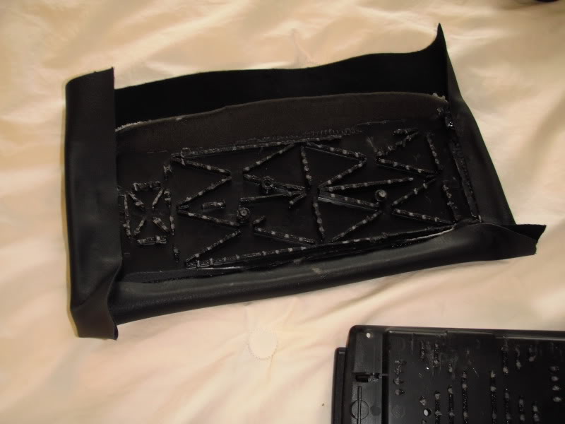

Step 3:
Cut and wrap the new leather. I used Gorilla glue as it reacts with leather almost instant.

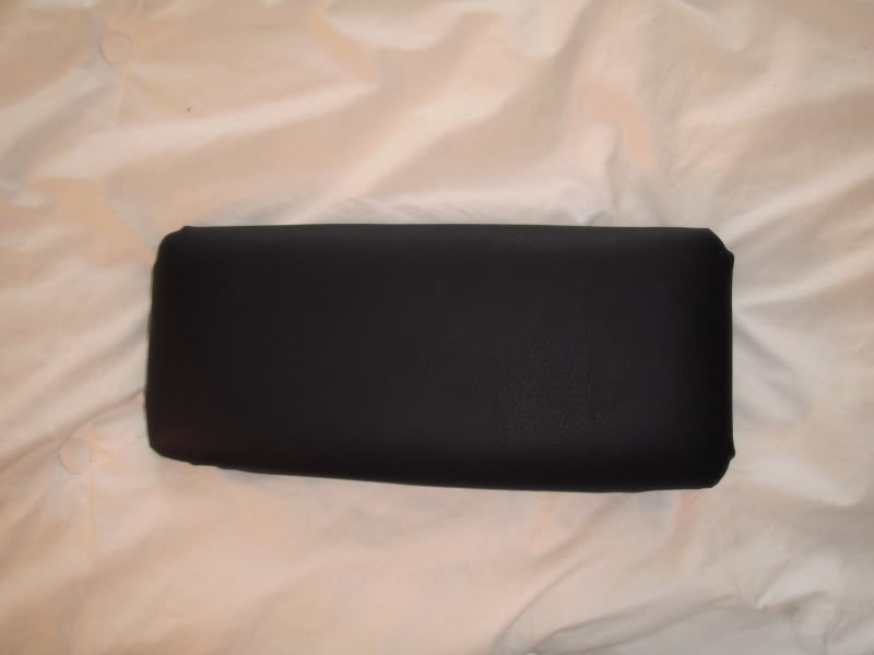

Before:

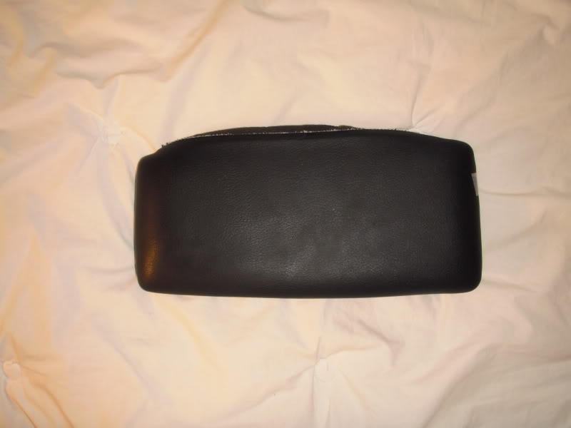

After:
Not perfect, but worth $8 and a little time...
