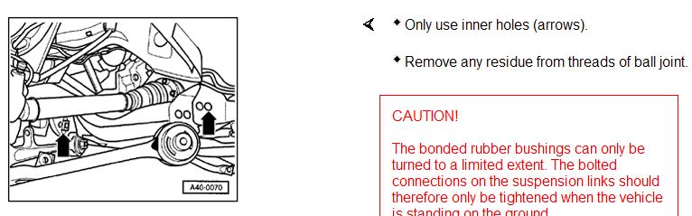

Another thought. I saw a B5 where they guy put the lower rear arm in the wrong hole. It's easy to do. See Bentley here. If you did it on both sides you'd make negative camber and toe in at the same time. There's enough room on the tie rod that you could adjust the toe back to normal, but the neg camber would still be there.
