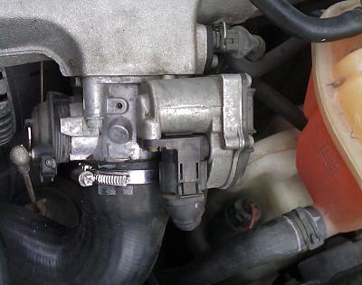

After I put the key on the ignition and switch it to on position I hear this long beep coming from the engine area. most likely from the first picture attached.

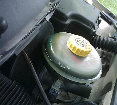

secondly, I noticed this leak in the reservoir (see pic 2 and 3). I wipe it clean and next day I see the same. If you look carefully you'll see the reservoir edge has decayed a bit. maybe that's where the fluid is leaking from? I take this is brake oil reservoir?

the long beeping noise is your throttle aligning itself. it is normal to hear that sound, but im not positive if it should do it ever time you start it up. knowing the engine/year would help, but from the looks of it it is a ndbw 1.8.
that certainly looks like the brake fluid resevoir, which im my opinion needs to be fixed asap. that is a system that you dont wanna loose pressure in.

How do you suggest I fix the brake oil reservoir?
