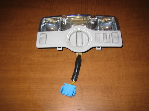

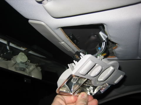

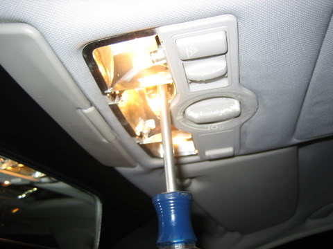

Remove the control assembly from the roof:
Remove 2 average sized phillip head screws:

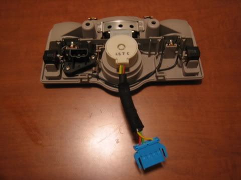

Carefully pull the module down and disconnect the 2 cables:

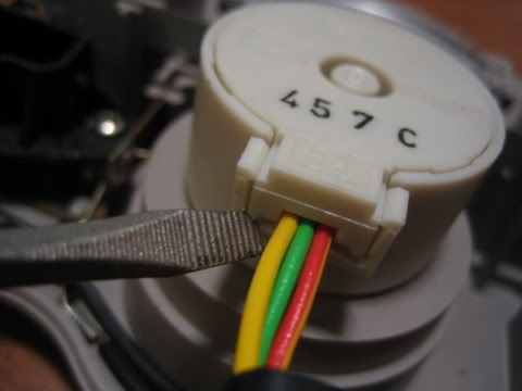

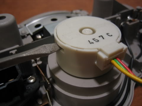

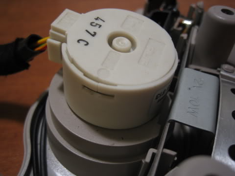

Next, more carefully than I did pry the back off the round switch part.
You can see that I cracked the housing a bit, you can do better, I believe in you.

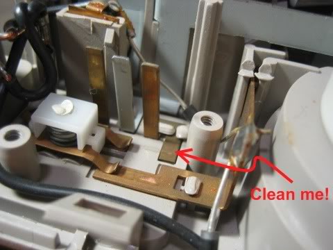

Now with the switch open you can see how it works. (you may not get through the next paragraph if you're ADHD)

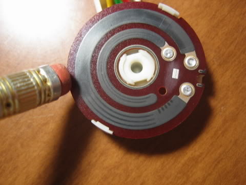

There's a couple of sets of wipers that run along a resistive surface. The voltage will vary from 5 volts to 0 volts depending what end of the surface the wipers are contacting. For instance 2.5 volts would be the switch setting for the roof to be closed. 4 volts would be the point where the roof should be open, and at 1 volt the rear of the roof should be popped up. (I made those numbers up) The demons live in those black tracks on the resistive surface. While the wipers are parked at the 'roof closed' position those black tracks are messing up the connection between the wipers and the surface. This causes the wrong voltage to get fed to the motor controller and it sometimes sees 1 volt instead of 2.5 volts and it opens the roof for you. To fix this just clean up the resistive surface, and the wiper contacts.
A pencil eraser works fine to clean the surface without being too hard on it. Also clean up the wipers if needed, be careful with the wipers they look fragile. Final clean up with holy water or contact cleaner and you're set.
While you're in here, clean the interior lights contact too. You'll have to remove two more small phillips screws and pull the connector off. Kind of hard to get at the contacts but try and brighten them up a bit to keep things working for a while longer.
