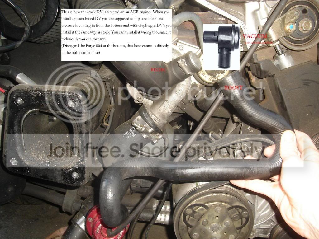

DSC00614.jpg?
valve will be on either the top or bottom of that hose i'm holding (yours will be on the bottom)
Note:
yes it might installed either way and installed by Audi either way, but the diaphram will not last very long if put in with boost hitting the bottom of the valve since this means there is pressure being put on both sides of the diaphram. Only works for "stock" boost levels. So when ever using a diaphram type of valve like the stock Bosch valve it should always be installed facing the same direction as pictured above.
