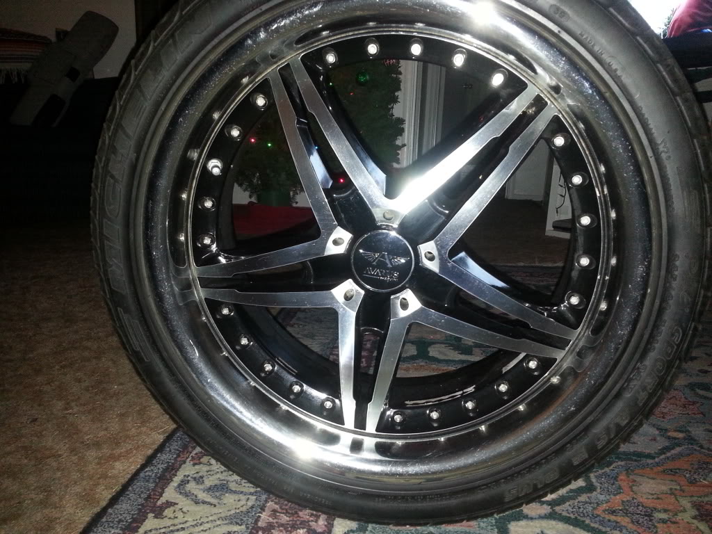

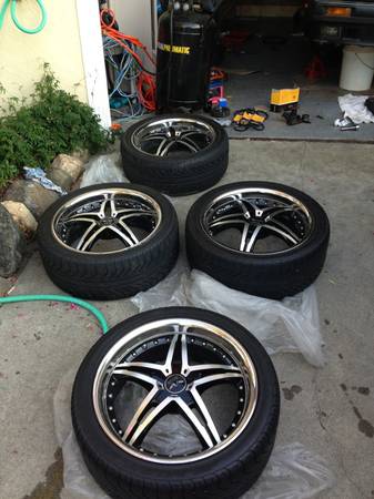

I just got some 19'' avarus rims with tires for a steal! The tires are MIchelin 245/40 zr19... It's gonna look good... the best part.. i paid two hundred for the whole lot... But when i was trying toput them on last night i couldn't for the life of me get the stock wheels onthe drivers side off the Axel... i tired everything.. i read all the past posts about it and tried it all.. laying on my back and kicking as hard as i could.. i rubber mallited it.. i even took out the bfh... with no luck... wd40 is soaking on tthem now as we speak.. my question is if anyone else has any other suggestions... please help... the passenger side came right off though... But of course more problems... The top and inside lip of the tire is hella touching the upper control arm and the shock... my second question is what cab i do about this if anything? Spacers work? If so what size.. thanks allot...
There gonna look good...

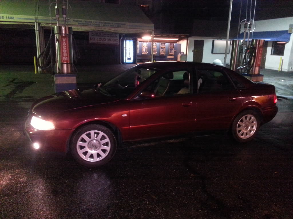

And this is what she looks like now :-(
