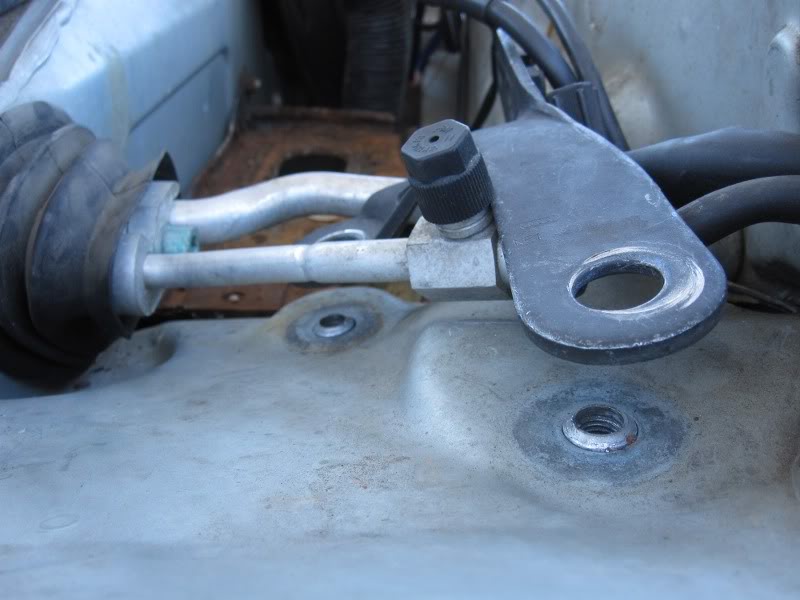

Recently I came across this:
http://www.audiworld.com/tech/wheel32.shtml
And bought all the parts to do it. Problem is, my AC pipes don't look like that... Anybody with the pre-facelift AC pipes successfully fit the passenger side bracket? I'm thinking maybe some trimming of the bracket is required, but if others have done this your input would be appreciated.

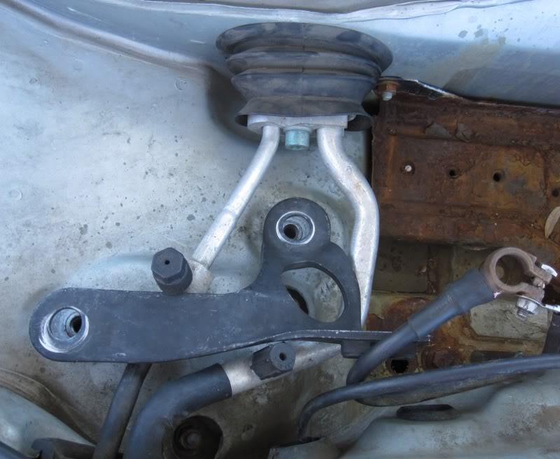

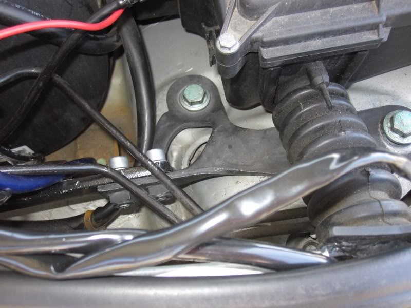

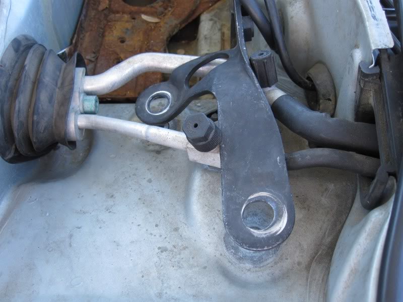

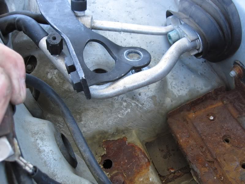

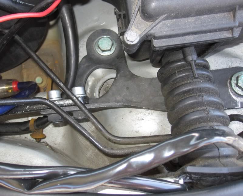

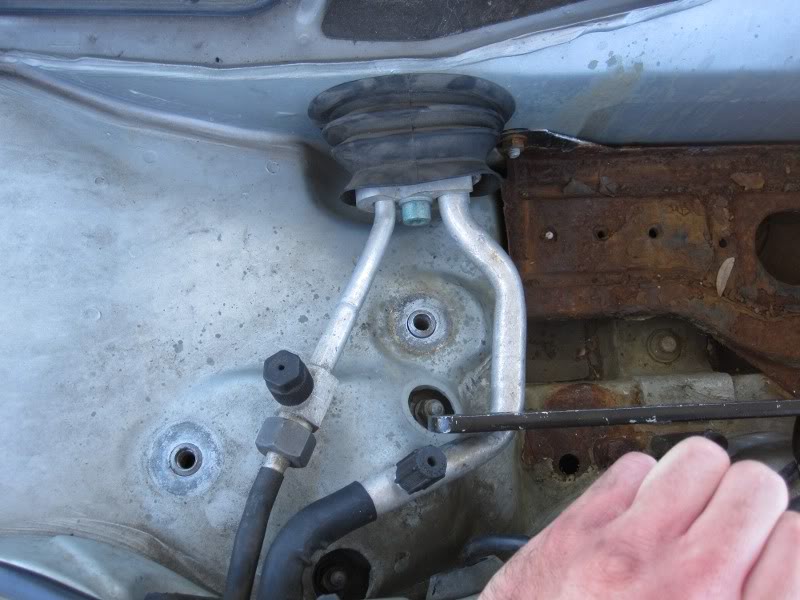

No luck... Those AC pipes are way too much in the way. The driver side barely fit too, the brake lines from the brake booster almost interfered with the bar.
Driver side (don't mind the wires):

Passenger side:
So, anybody with AC lines that don't look like these (that look more like the ones in the DIY link) want to buy this setup from me?

Check your engine bay
The bracket won't fit under the lines, the lines would have to be severely bent check the DIY in the first post, if your AC lines look like that then they'll fit!
