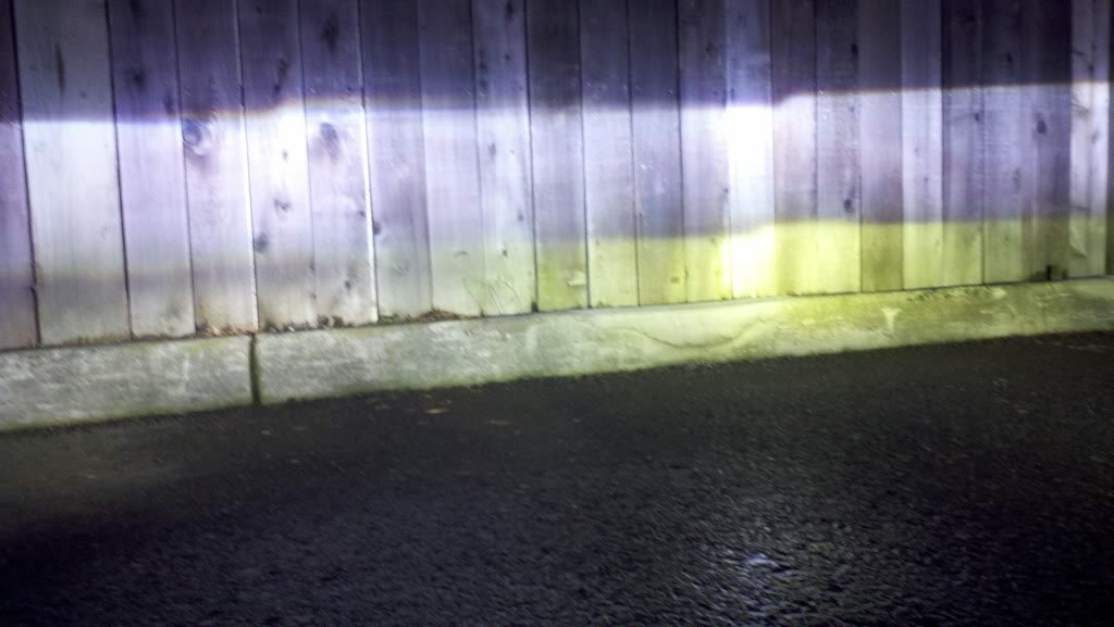

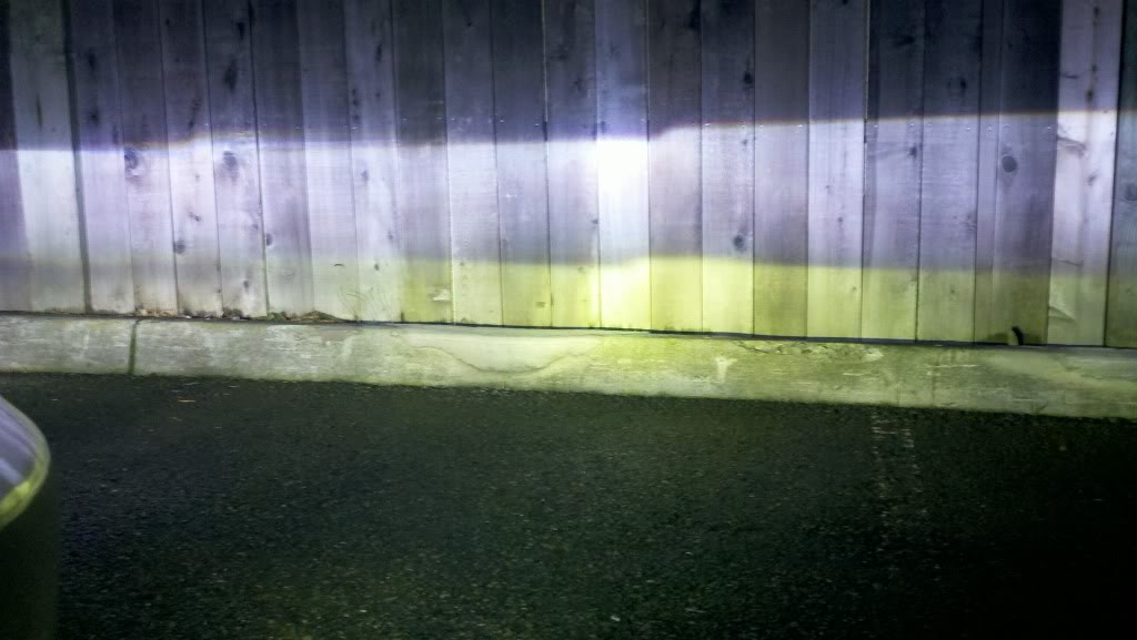

I had some time today to get around to installing the retrofit fog and HID setup. I forgot to get pics with the headlights off, but the fact that you can see them with the headlights (55W 5000K FX-Rs) on is pretty good.
Stock halogen fog on the left, retro on the right.
Before someone says it, I need to adjust the rotation on my passenger side headlight. It's a work in progress.
The lamin-x certainly dulls the cutoff a bit, but I'm not really looking for a razor sharp cutoff on the fogs. HID setup is 35W 3000K. Without the yellow lamin-x, the cutoff would appear green...

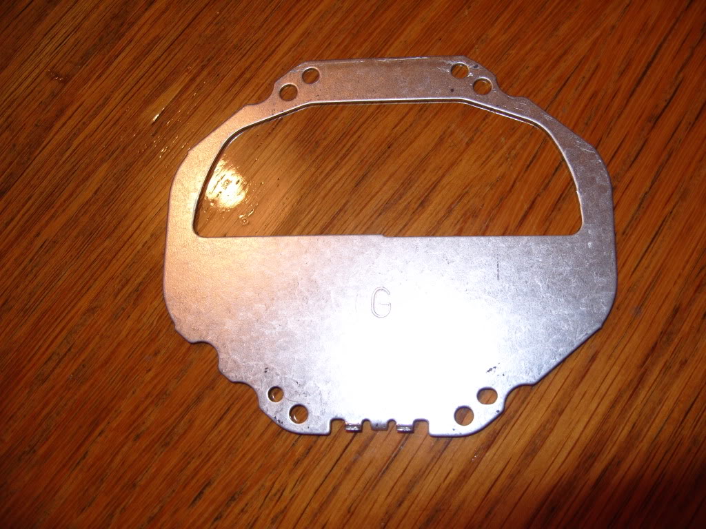

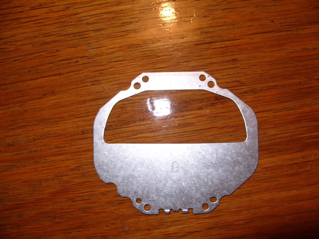

Not a real update, but I decided I wanted a flat cutoff for the fogs. Don't really need a step that low to the ground.
Before:
After:
