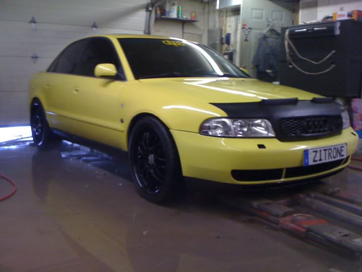

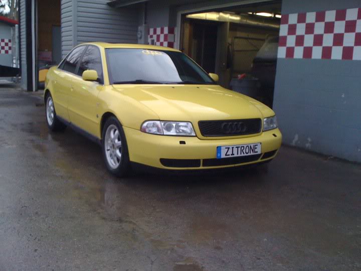

Think you could show me a picture of your wheel gap? Are you on stock shocks?
Yes I'm on stock shocks (non-sport). Here's pictures with stock wheels and my 19's.
