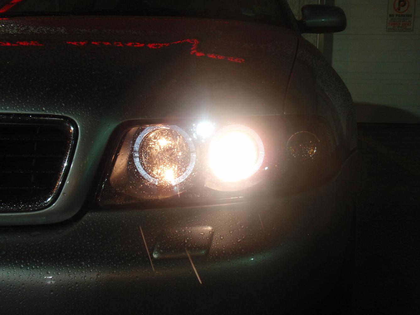

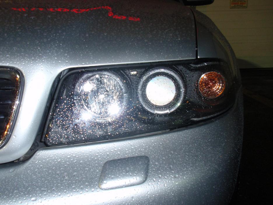

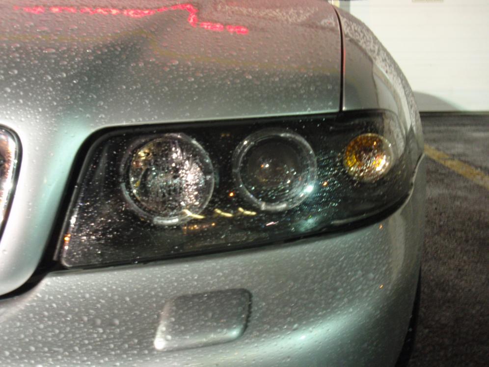

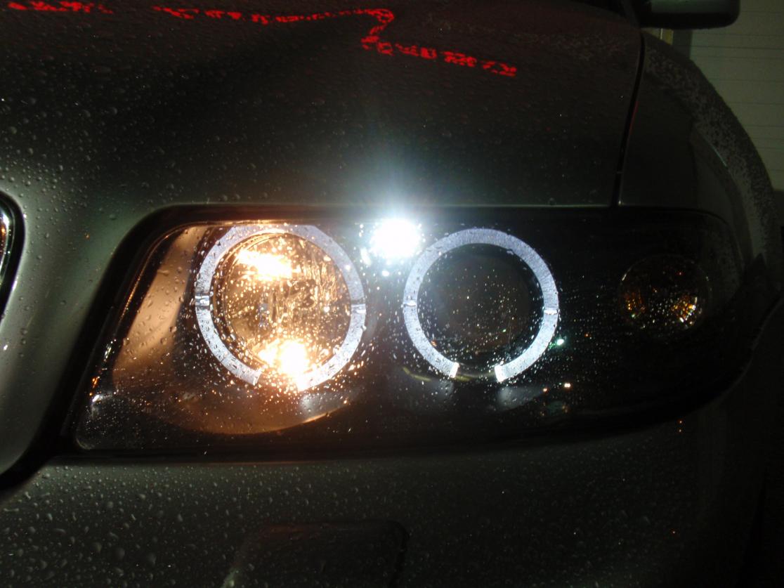

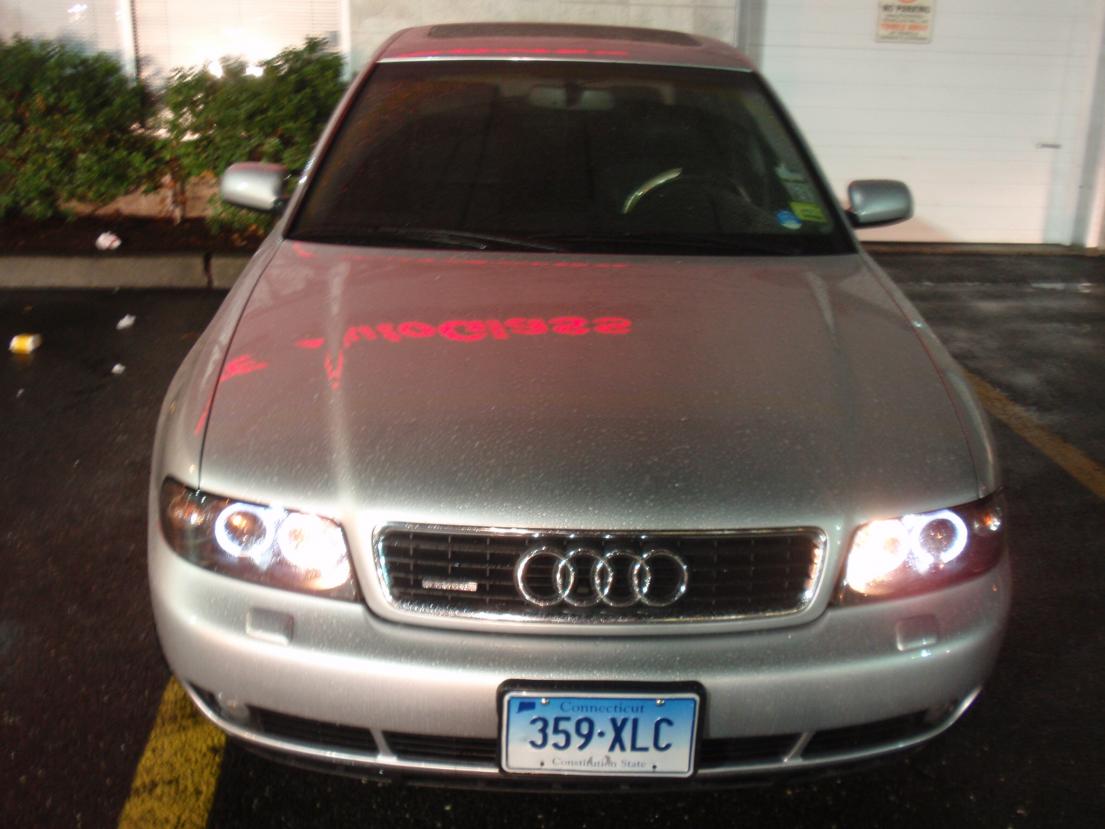

I think it's ignorant for somone to say a perticular style of lights should not be on an Audi,it's not your car,for a person to trash someone that has a style that you don't like,it's so childish and junveile,everyone has different tastes about what looks good on their car,if i look at another B5 with this or that on it and i don't like it,i would never trash it behind or to his face,i'll simply say,"its not for me or i may even like it but say"its not for me".
I like my Angel eye lights on my B5,i can care less what some stranger on a forum thinks about how it looks on "my" car.
I am not talking about your post jdahlen24,was reffering to the guy with the BMW in his sig..which is really ironic,being he has a BMW for a sig on a Audi forum,yet he is bashing people that have Halo or Angel eye lights on their B5,go figure that one.
