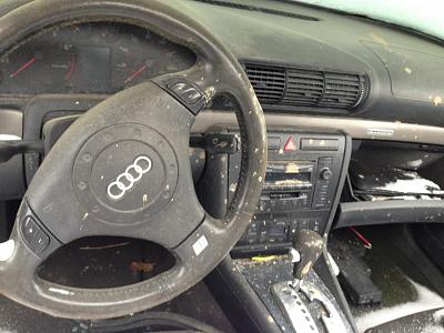

Here is a pic of the interior someone removed the sunroof right after I looked at it the first time

That's the one I'm talking about. Follow this guide and you'll have all the info you need for doing the work, as well as a full list of what parts you need. I did it on mine last year - the link is complete and gives you everything. One addition I'd make though - you'll extend the wires for the rear defroster and plug them into the switch on the new setup. The terminals are very close, so use the female blade terminals that have the insulated plastic cases over them so the wires don't short against each other.
Here's the link:
DIY B5 A4 Center Console facelift upgrade
