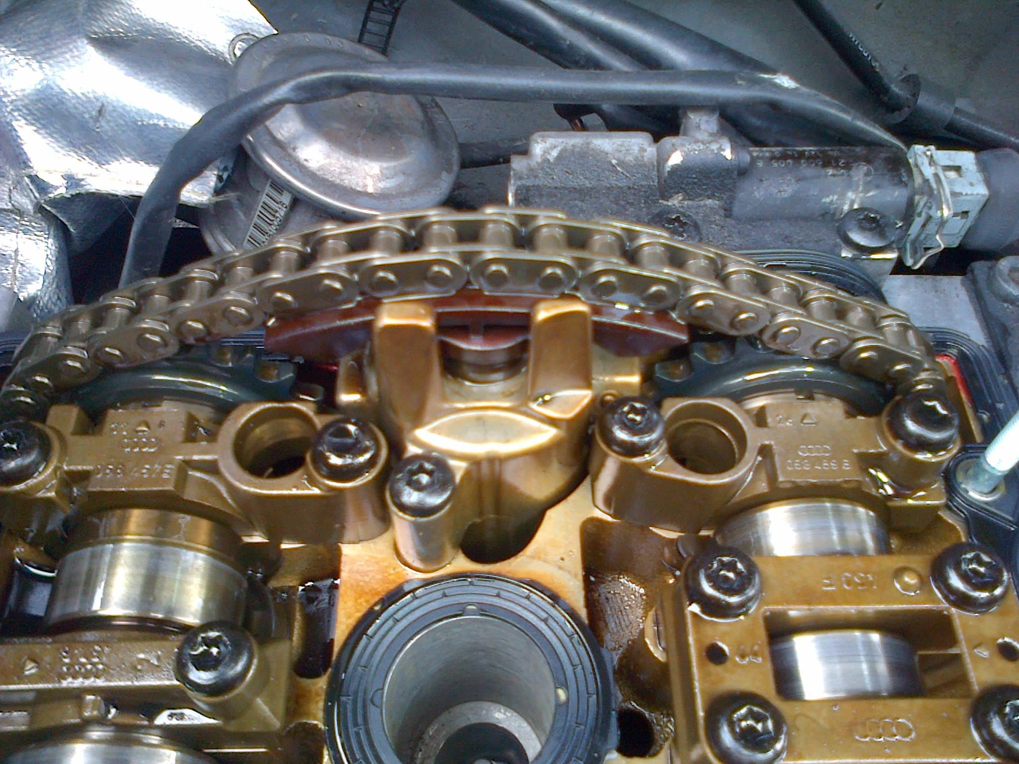

Did you triple check 16 rollers between timing marks? Sounds like something may be borked. Can you take the valve cover back off and snap a pic of the chain?

yes checked everything was lined up, just can't see whats happened. Ill get a pic asap, if it was out how do i get it back?
Heres a pic of the chain all lines up with 16 links and the crank on the front of the engine lines up with the notchs
