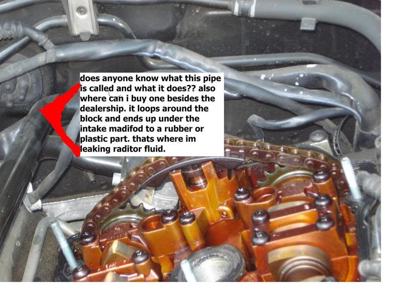

here's another picture

please anyone know that that whole pipe is called or where i can find it????????? pleaseeeeeeeeeeeeeeeee

if your talking about the metal pipe, that is for air not fluid. that is not a coolant line. your leak is coming from something else.

that tube connects to the crank case breather tube and pcv system. all for air not coolant.

ohhh ok. i just thought that where it was leaking from cuz its was always wet...

If you leaking coolant from back there its most likely the coolant flange at the back of the head. That hose is just the PCV pipe from the PCV valve to the crank case.
