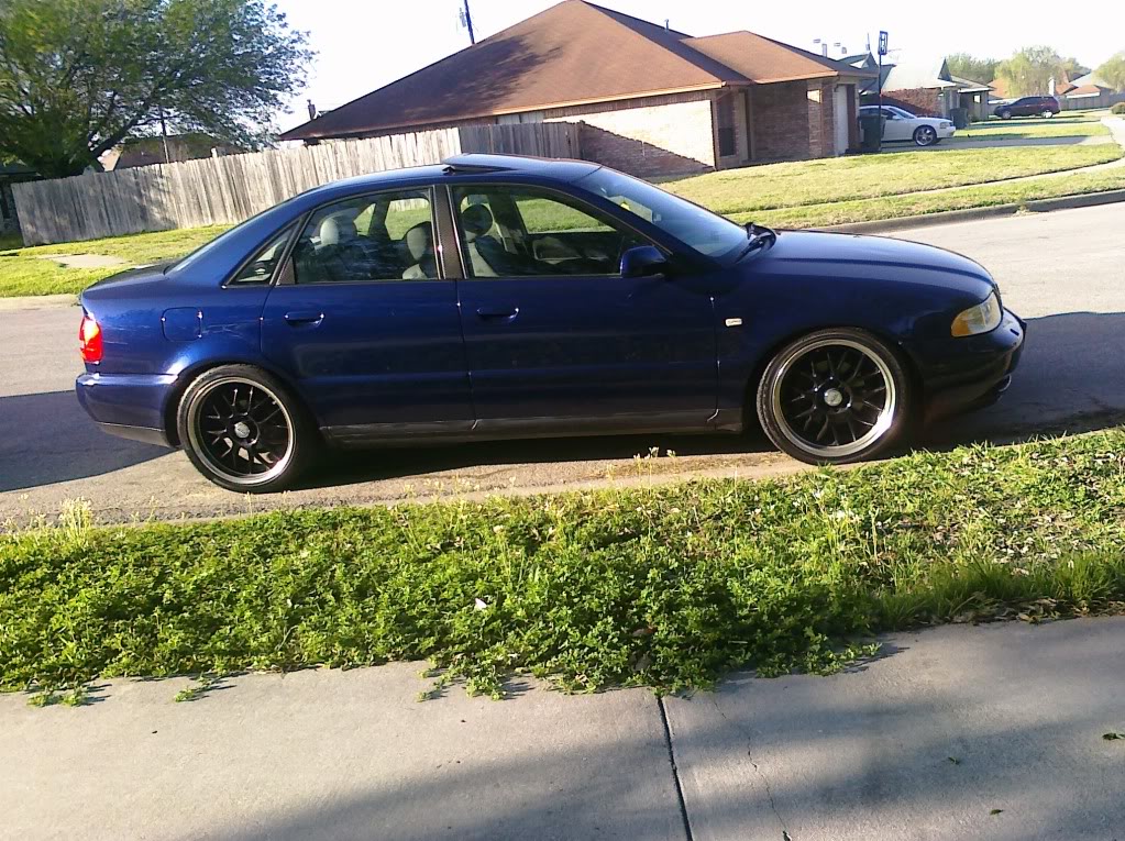

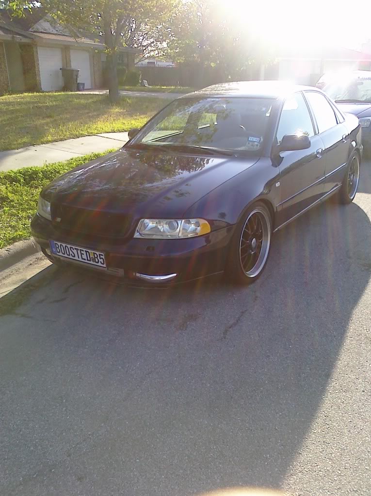

I lowered my 01 1.8tq with V-maxx coilovers a couple weeks ago. I've been noticing lately that my camber is becoming more and more out of whack. It was extremely noticeable when I had my buddy drive my car and I drove behind him so I could see for myself. I took a look under the car to look at the rear tires and I wanted to cry. The inner part of the tire is really worn and the outer looks brand new! I've been looking around and I can't find anything that can fix this. If I can't get it fixed, I'm gonna have to throw back on the monster truck suspension. Anybody have any suggestions on what to do at this point? I know I am going to have to buy new tires, so that's covered, but I want to fix the problem first. Would new control arms help? Did I put the suspension back together wrong for it to be so out of whack and cause tire-wear so quickly? Is there a camber correction kit for the B5? The front's are nearly as bad as the rears. Thanks in advance. Oh yeah, here's a pic of my car and how low I dropped it. These were taken about 2 days after it was lowered. I'm not rubbing and I wouldn't consider it slammed either...

mine is about as low as yours, is it 1.5?

Hmmm... I'm about about 24" gtf and haven't had any problems like that. However I'm on stock 7" wide wheels and yours I'm assuming are 18x8. The extra one inch may play a part in the horrible tire wear. I'm too lazy to explain why I think it may be a problem haha.
