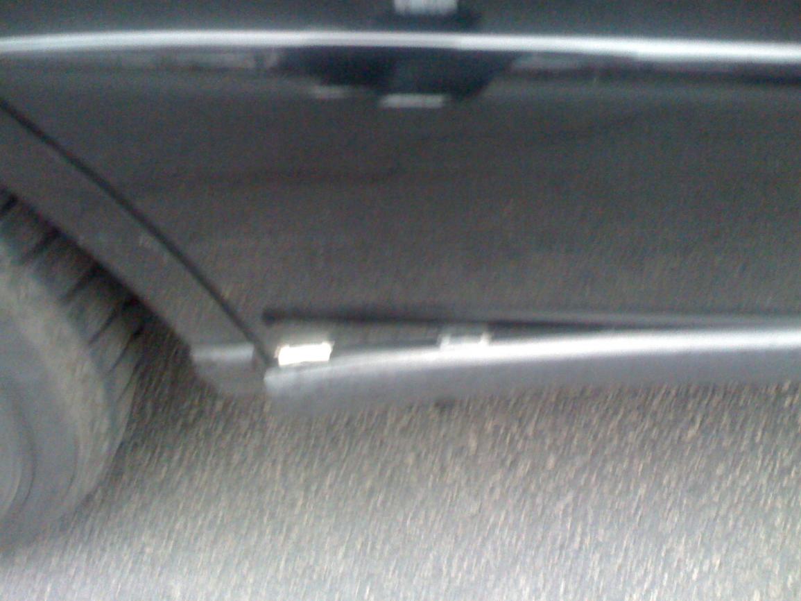

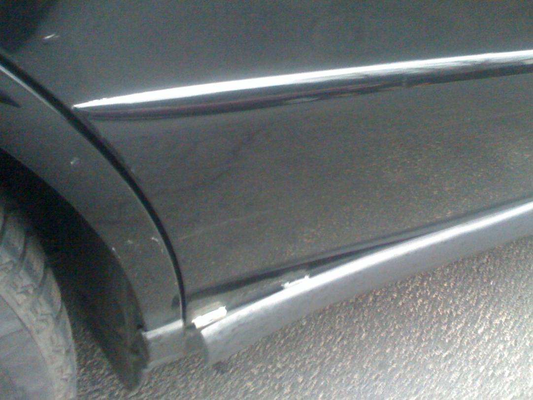

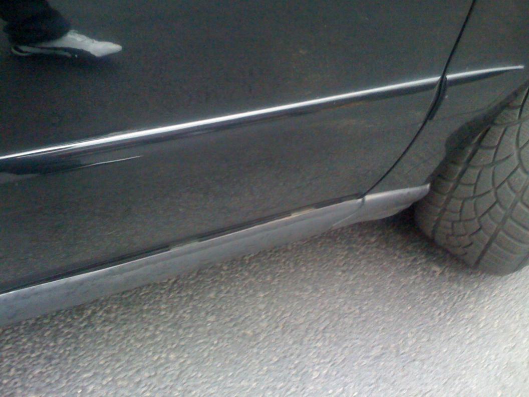

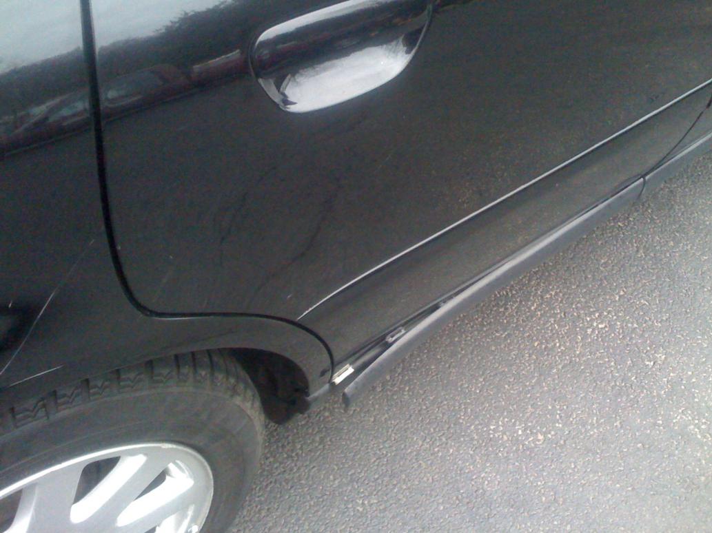

hello... i have a problem with my audi's side trim that goes along the bottom of each side of the car, is kind of coming out and falling apart. here are some pics so u guys see what im talking about, this is actually my car and the actual status of the trim... please, how do i fix this... thnxss!

The receivers for those clips, on the backside of the trim, are broken. Order new lower trim from www.ecstuning.com and install it - it's easy and not expensive.

The little tangs on the plastic clips might be broken too. Get a few of those while you're at it. You'll probably want to do all 4 moldings; the new ones will look much darker than the old, faded ones.
