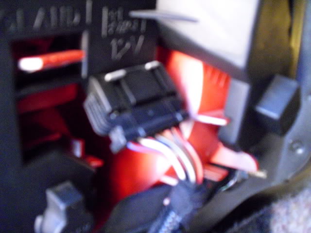

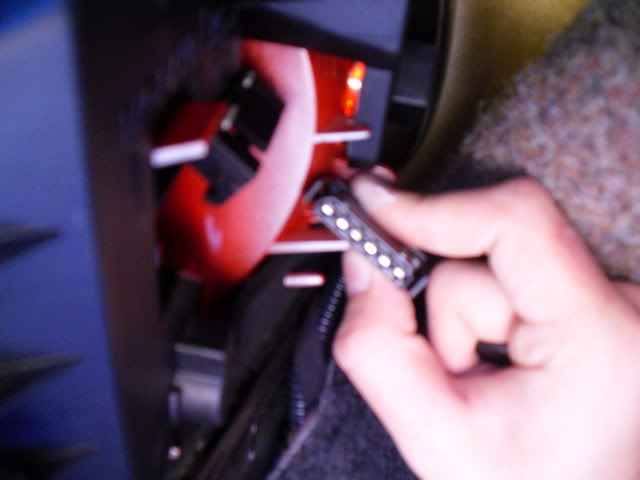

and i lied about the 2 connections, i guess i was remembering my friends tail light i helped replace.
there should be only 1!
it should take you 10-15 minutes max to swap them out if they're plug'n play.
there are actually only 2 plastic things that you need to screw off to get the carpet to peel back, and there are 4 bolts on the tail lights that need to be taken off.

could i try the connections without removing the tail light? just set it in the trunk and plug in all the connections?
Old Aug 27, 2010 | 05:00 PM
twoeightquattro's Avatar
Joined: Jul 2010
Posts: 434
yeah for sure,
the connection i showed in my picture is with my tail light still on the car.
definitely test it out.
