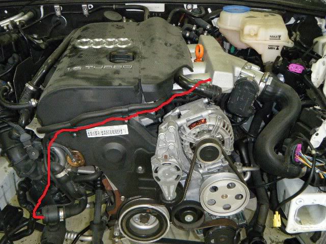

replace the vac line, it goes from the dv to the front of the intake manifold on a brass nipple. heres the best diagram i can get.
red line = vac line
red line = vac line
Yea thanks alot for that. You think you could do the same red line for the other major vac lines?
