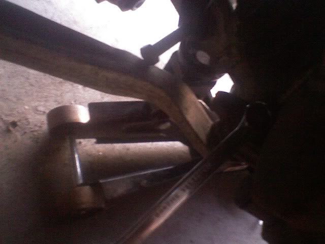

heres what im dealing with... its hitting on that part of the sontrol arm or whatever
do you see the nut that my wrench is on right now? if i loosen that will that arm come loose so i can get that bolt free or will i fk myself if i try taking that off to move it.

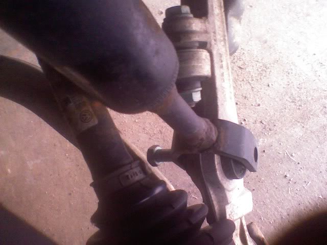

ok well i just took off that bolt im referring to on the control arm, and it looks like it has a space for a hex hed / allen wrench... do i need to use one of these now to take that off or should i be able to hammer on it to get it down? (dont want to strip the threads by beating on it if its not the way to do it)

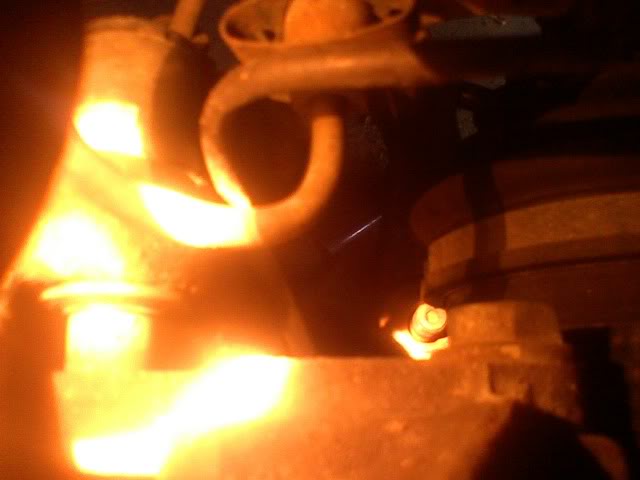

i tried taking a pic of what im talking about... idk if you can really see it but its in the center right of the picture in the light.
thanks everyone again
I assume that's a shot looking down at the ground behind the hub, of the control arm bolt that connects to the knuckle. You do not need to take that out. The easiest way to get the stuck bolt out is to twist the control arm that the shock is connected to with a wrench and then drive the lower shock bolt out with a drift pin or long socket extension.
